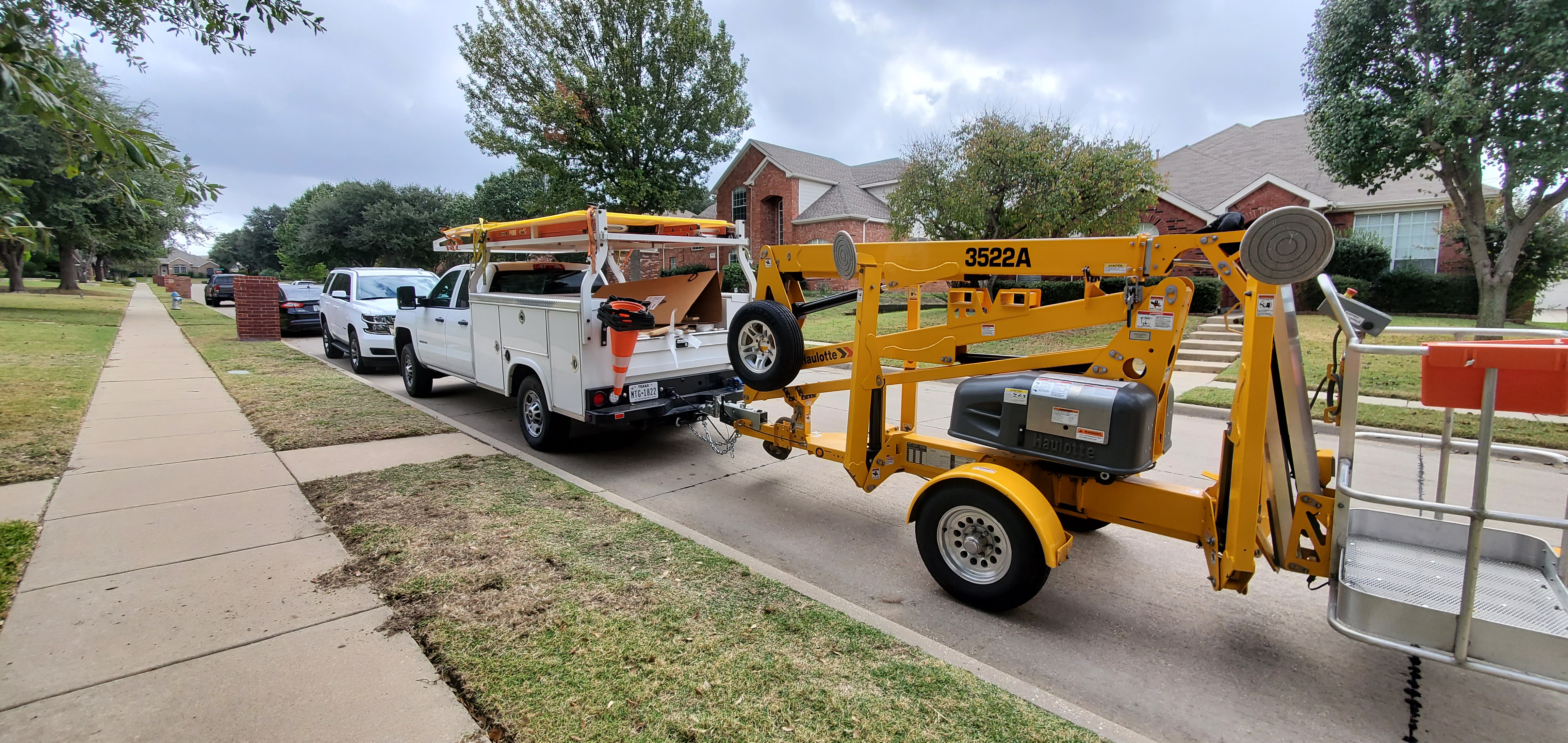

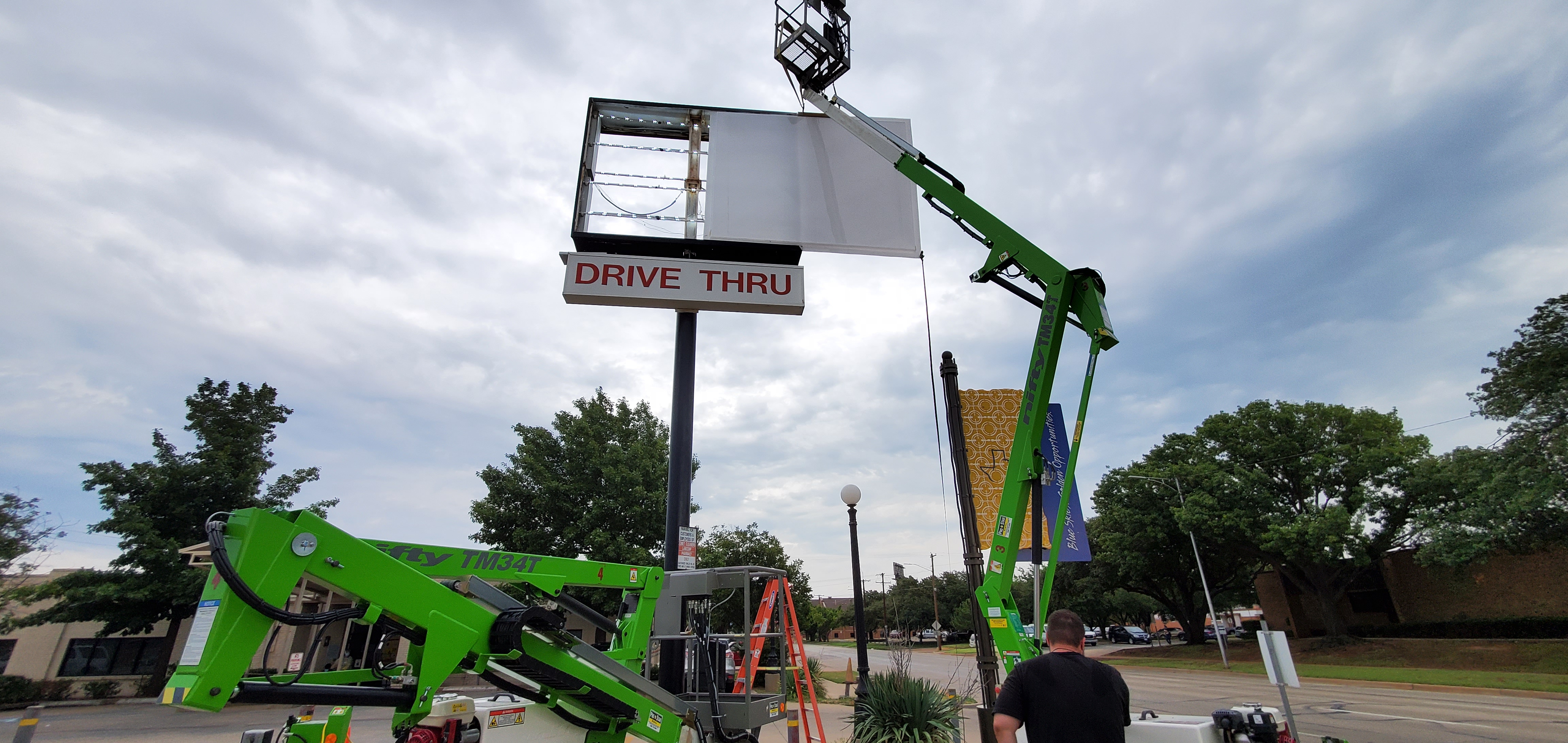

Using a pan face will make it a million times easier. I'd transport that size face on a trailer. If it's pan, you likely can do it with one bucket and two he/shes/its. If it's a flat face, I'd price out two buckets for sure. I've transported flat polycarb rolled up and ratchet strapped closed. That size though might be tricky. I've also strapped them to the roof rack of my truck.
If it's 10' tall, I would clamp a 2x4 along the middle of the top edge and lift it up with crane/bucket. This would require trucks.

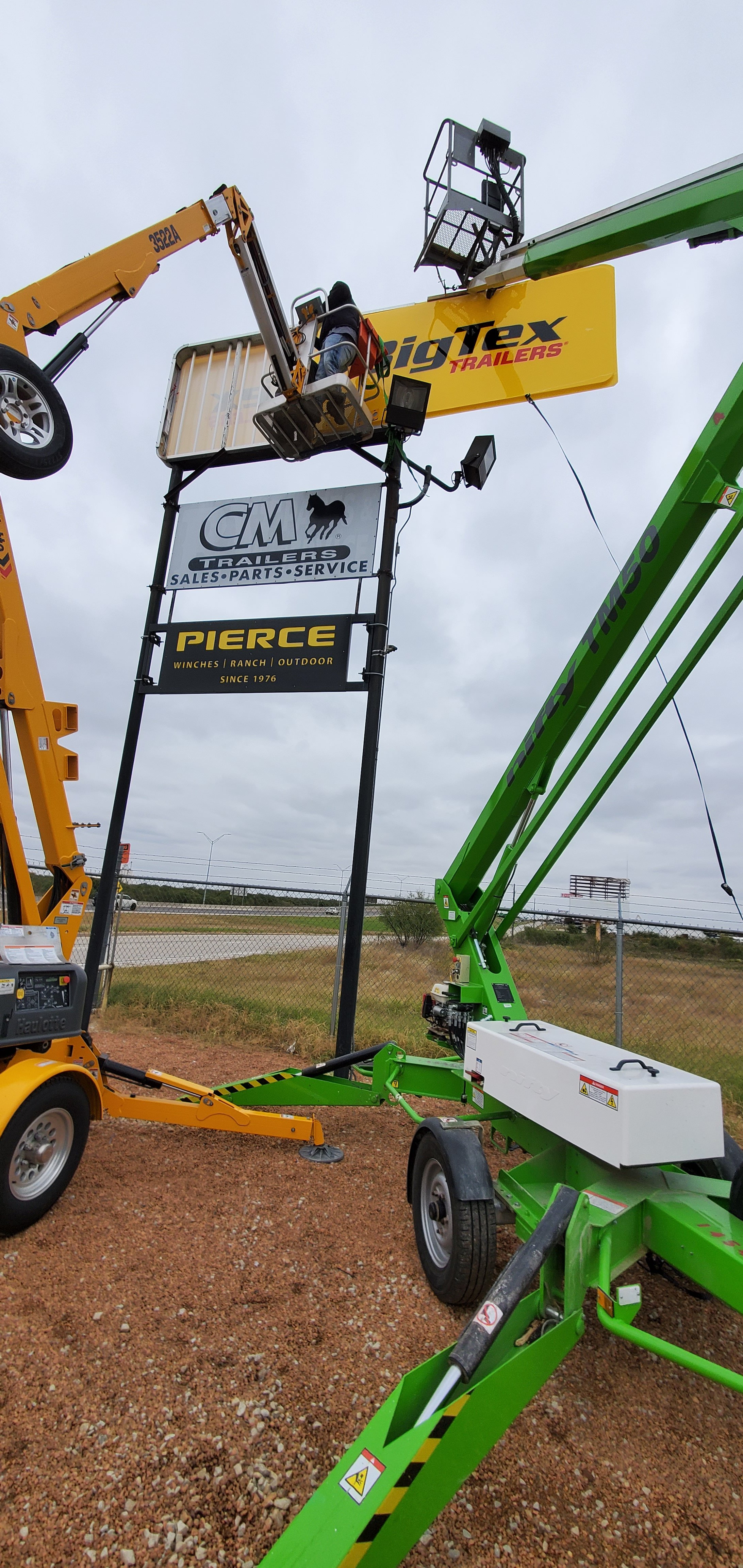

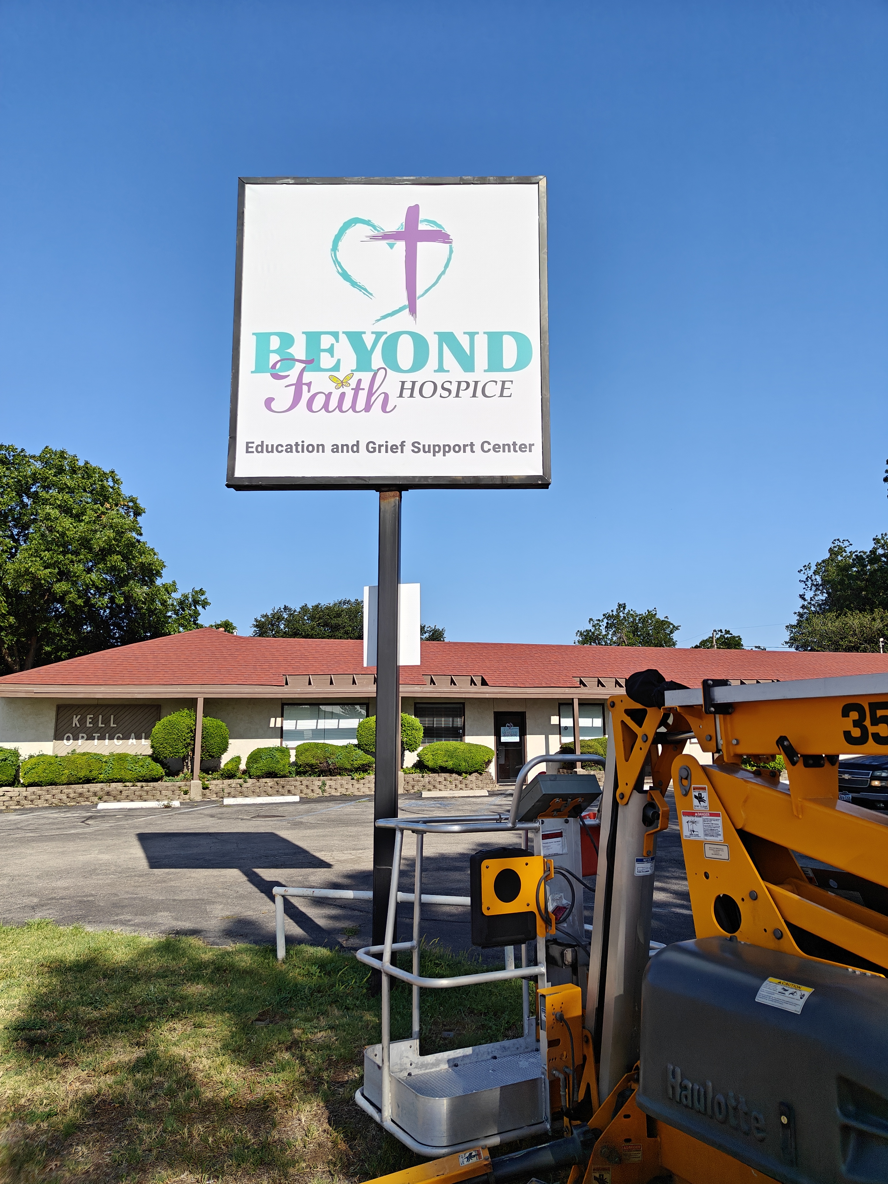

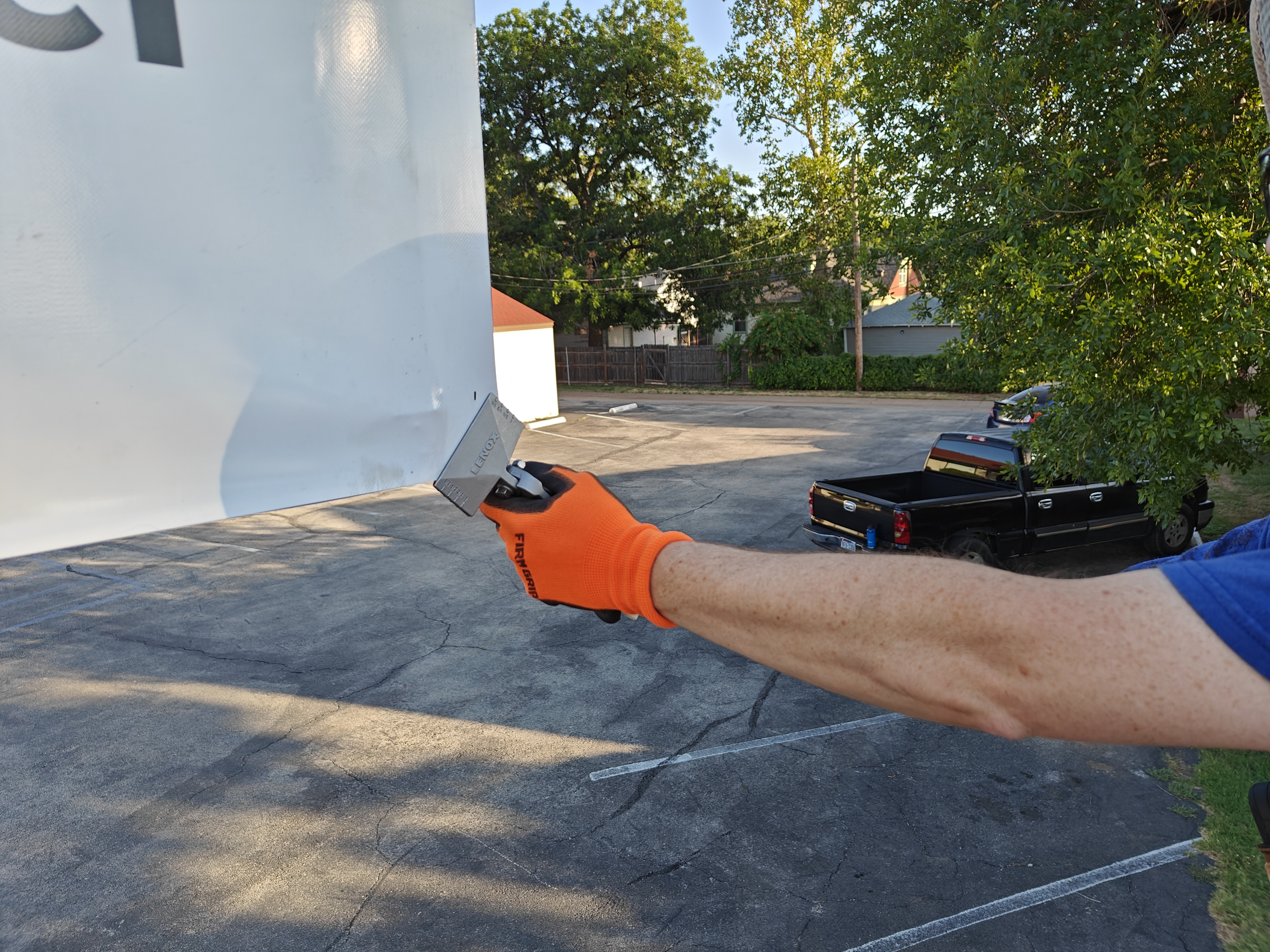

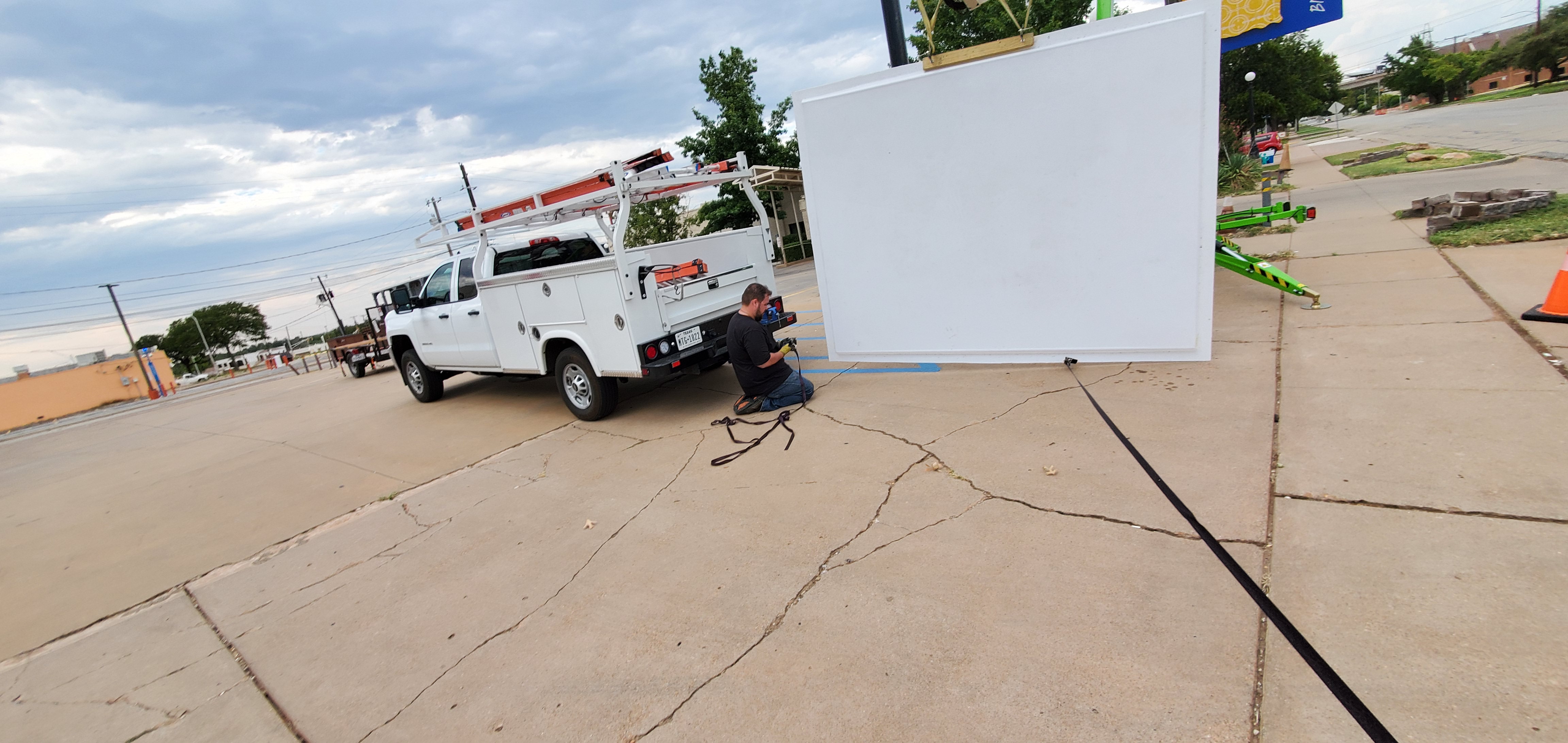

You run tag lines. That one pic of the BigTex face was installed in 40mph winds. I had the client hold one of the tag lines while I lifted.
And I agree with brad.. flexface that bitch. This one is self tappers and rubber washers. Takes two people but only one bucket. My helper uses duck bills to pull the face while I fasten. Use plenty of fasteners and it's not going anywhere.
