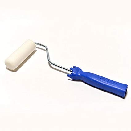

Try a high density foam roller. Youll need more than 1 coat but it should be smoother and carry less paint which will help the runs.
Get a couple, the solvent in the paint makes them swell up after a bit.

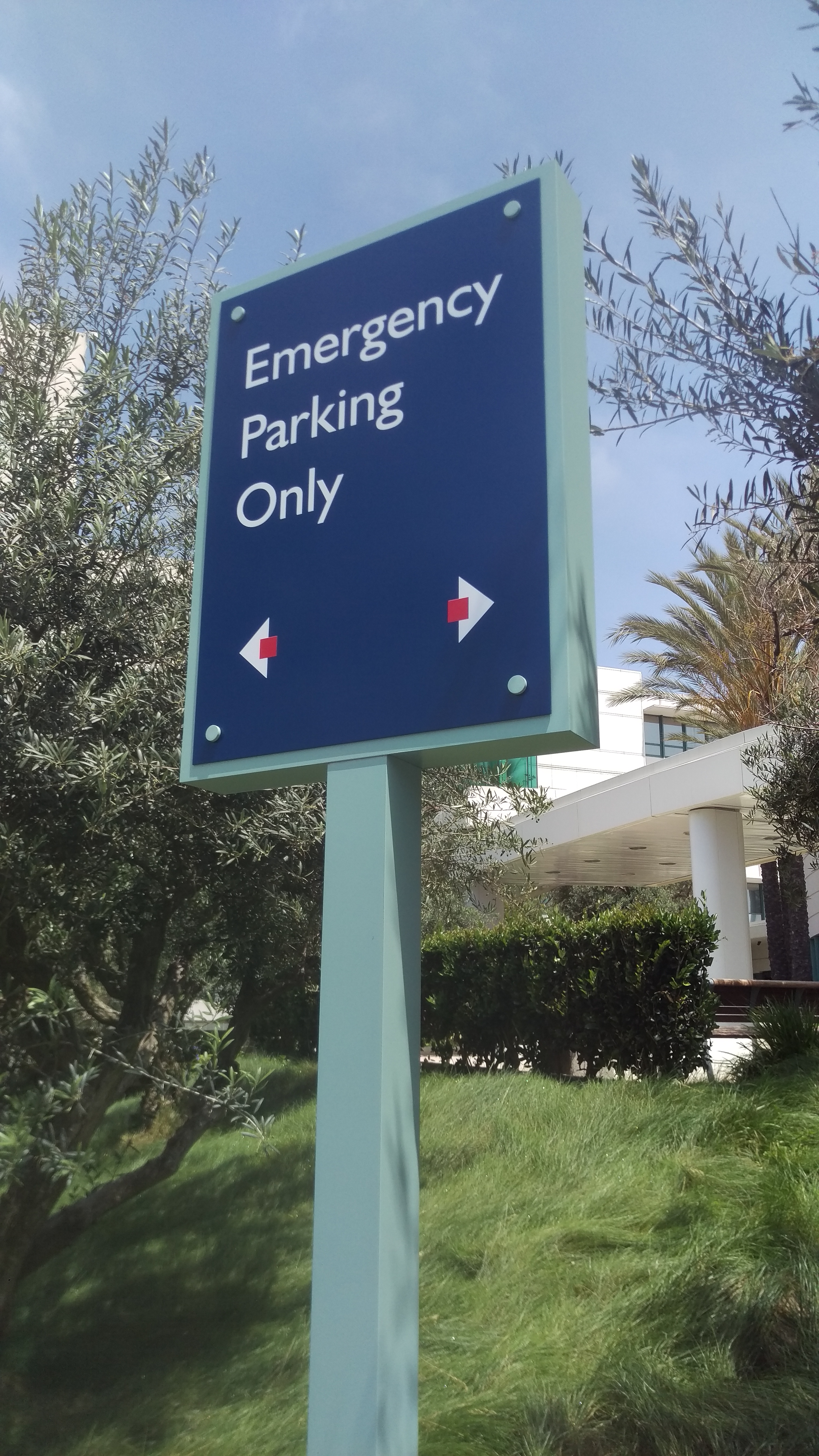

I've use this before and worked great. I painted a steel bracket well over a year and left it outside to test out and still looks good rain and shine. Here is a directory that we painted with it and super smooth using a foam roller. We did about 30 of these.
