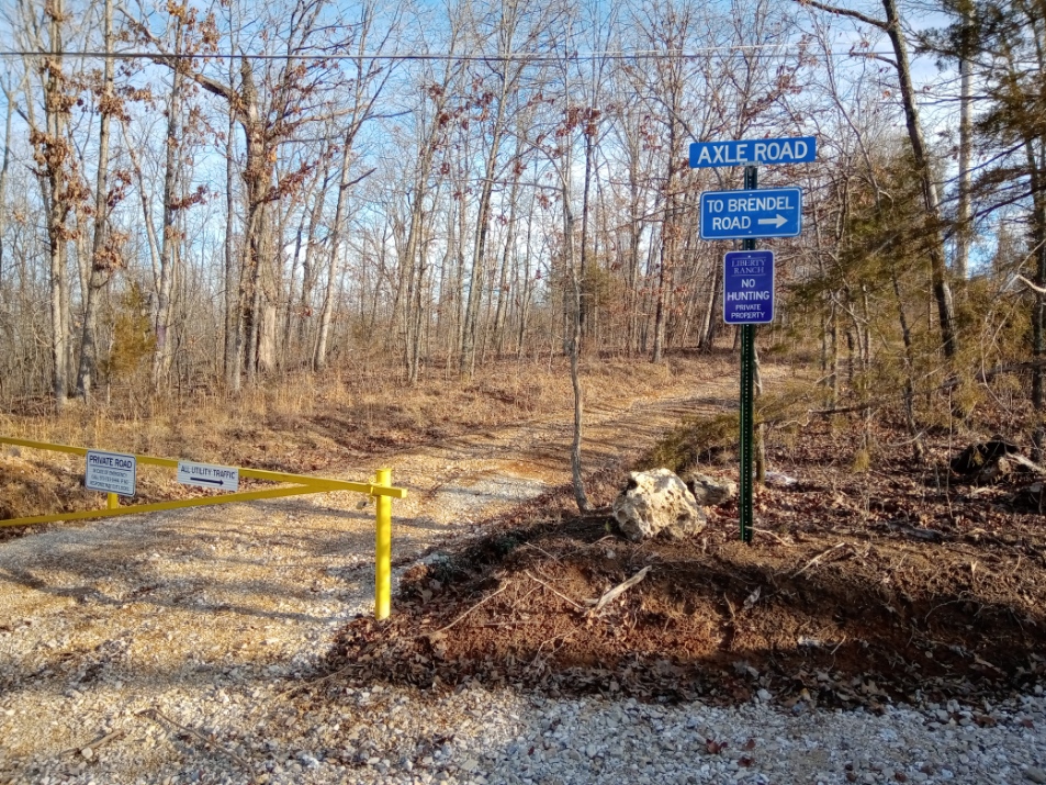

We just put up about 30 of these, some with square poles and just the no hunting, some u-channel with just the no hunting. The ground was undisturbed in some places, excavated like here, or fill where they had built up the roadbed. Obviously we hit rock (it is the Ozarks) in some places and had to adjust the position of the sign slightly to find a way through, but we averaged about 4 an hour including driving and hiking around to the sites. That was with two men and a sign post driver (with post caps). If I were charging for one sign, I'd charge for travel time, and an hour for the installation.
