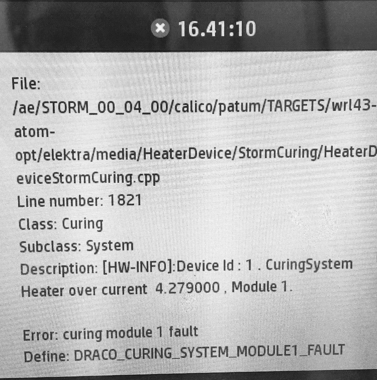

Good to see some life coming back! I had two heater issues pop up last week. Here is the error message. Similar to your issue on the heater??
You have the opposite of ours... We have low voltage errors. Yours might need to be recalibrated, our second 570 needed the fans adjusted and the heater voltage calibrated.
