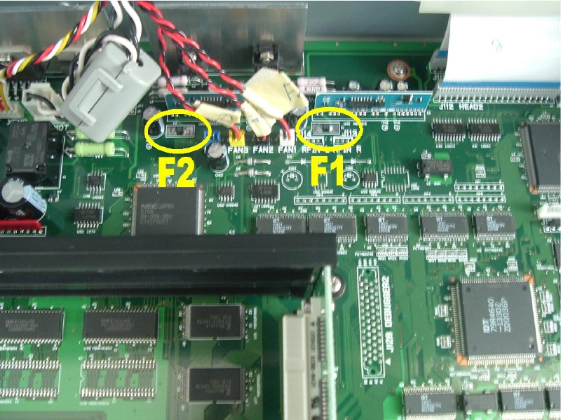

OK I will check that but what bout no printing other than K,C,M?
Not familiar with the head configuration on that printer but do all those 3 colors print from the same head? I think that printer has 2 heads doesn't it? Could be cable is loose or bad. Maybe fuse on mainboard for the head blown?

This is From CMYKparts.com He has fuses also.

Thank you! OK so now that I have them located is there a way to test them with a volt meter? I have never seen a fuse like that! How do you go about changing them?
OK I put the ohm meter to it and I am getting a reading from F2 but nothing on F1. Is that the fuse for the head that prints the Y, LC, LM? And how the heck do you change these? I have never changed a fuse that looks like this before.
randya
YEAH!!!
Surface mount fuses can be a bit tricky, but I know someone here that I just helped, was doing one of these, hopefully he will get on here and guide you along.
