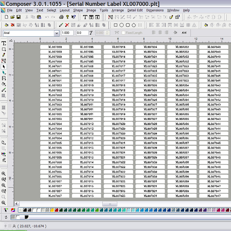

This is a bit of an odd repeat setup we do regularly for a client. He needs four identical serial number labels set together in sets in numerical order. We ended up running 8 sets vertically x 125 horizontally to produce 1000 sets. Updating the numbers for the 1000 sets using Reaction takes less than two minutes.

That's great Fred, you must love the time savings!
