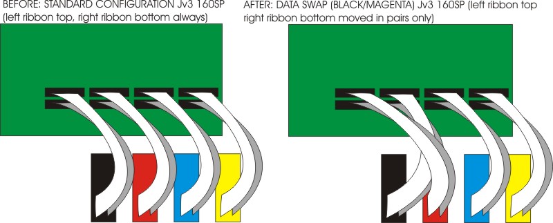

do a data swap next time, you don't have to take out heads to move data (illus. shows sp model).
the only way you are going get that printer working is if you have a proxy head. that is, a clogged or mechanically damaged head that is electronically fine. put the head in the lmlc position and the firmware will not 07 that head. you really don't even have install it. you can duct tape it to the carriage if you are in a hurry. over time (months) that head will fail electronically because the ink acts as coolant and it will be hotter than it is specified to be.
then i rasterlink, just choose cmyk profiles (they will not have lm lc data).
