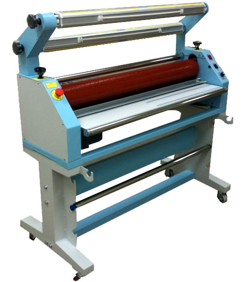

Can anyone tell what the difference is functionally between the MJ series and the AK series? The AK looks neater without the arms sticking up but I don't see anything in the specs that indicates you get more features in the AK series. If they are both the same from an operational viewpoint why not get the MJ and save $126. I need to make a decision before the sale price expires!!!:help
Bill43mx
So for anyone interested, I found the answer to my question above. I spoke with Tony at Master and he was very helpful in going over the features. The main difference between the AK and the MJ is that the AK's liner takeup reel is powered by the main roller motor via a chain drive. On the MJ the liner takeup is belt driven off of the laminate supply roller. Tony's opinion was that the powered version was much more consistent and better for doing long lamination runs. I'm pretty sure I'm ordering the AK 600 tomorrow.:clapping:
