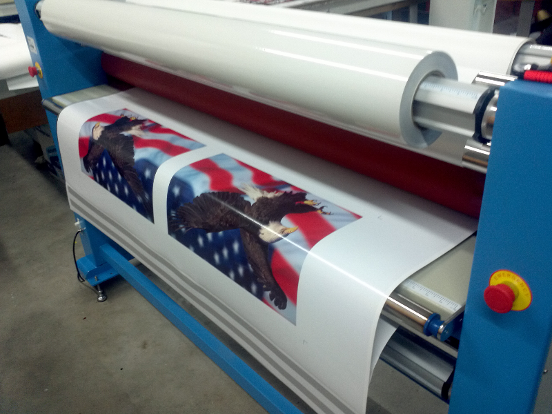

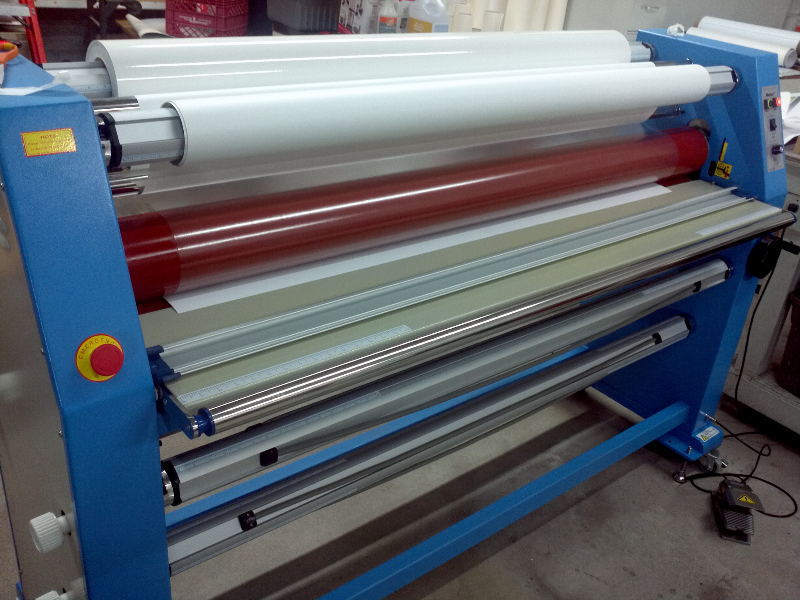

Just bought a 65in. us tech laminator, i gotta say its working perfect. Two thumbs up to everyone at the orlando office.

i did some research on them they look like a great piece for the price especially with the shots you attached...does that have a take up roller? i see 2 rollers at the bottom there congrats on the new equipment!
ironchef
No i don't. I was told you can use the backing from the scrap backing of the over laminate. And i think you need it if laminating smaller stuff. So the laminate doesn't touch the rollers.
ironchef
Yes it does. It has two bottom rollers for backing paper and the unlaminated roll. And one in the back that spins and collects the laminated media. I was up and running in less then a day. The longest part was taking it off the crate.
