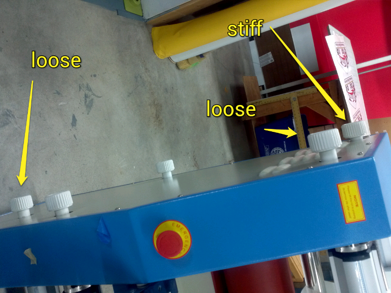

That's a good question scott. I haven't started printing yet.so hopefully you give me some pointers lol.... ill be sure to record the videos of the panels being laminated while i use my swiffer lol. And about the lam barely covering the print at the end... i think that was from my mimaki printers take up reel. Ill just try and be more precise when i attach it. Also, my tension knob is at its lowest strength. And i still find myself manually giving it slack. Any suggestions?
ironchef
Here is a pik ....

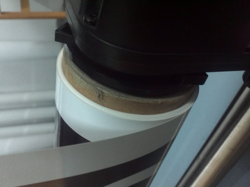

ironchef
The reel that i put the unlaminated roll on... maybe i need to grease it. Even at the loose setting. It still kinda pulls the vinyl. And its causing it to go off center. Or maybe its not that. Maybe its just that my printers take up reel didn't roll it up straight. And maybe that's causing it to move while laminating? I started printing at four. And i paid more attention to the take up reel. And i noticed its not rolling up totally on point its like 1/16 " off
ironchef
Coming out nice. On the printers take up reel
