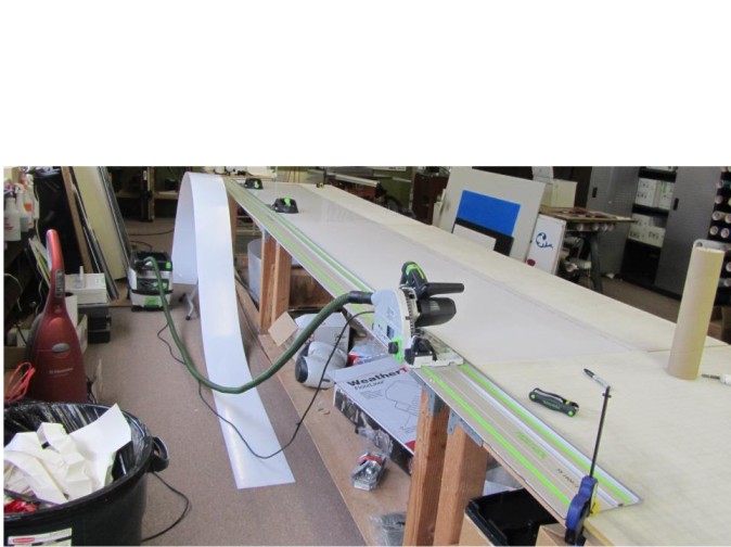

Here I am using mine for cutting down 16 ft Lexan

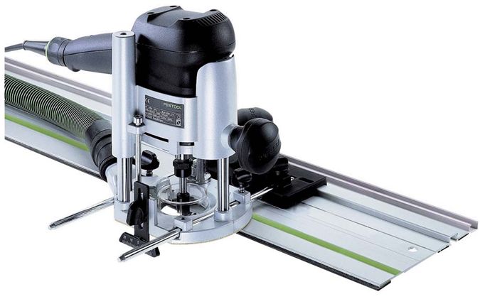

Oh one more thing I forgot to mention.The guide rail is also compatible with Festool routers so it has that advantage as well.
