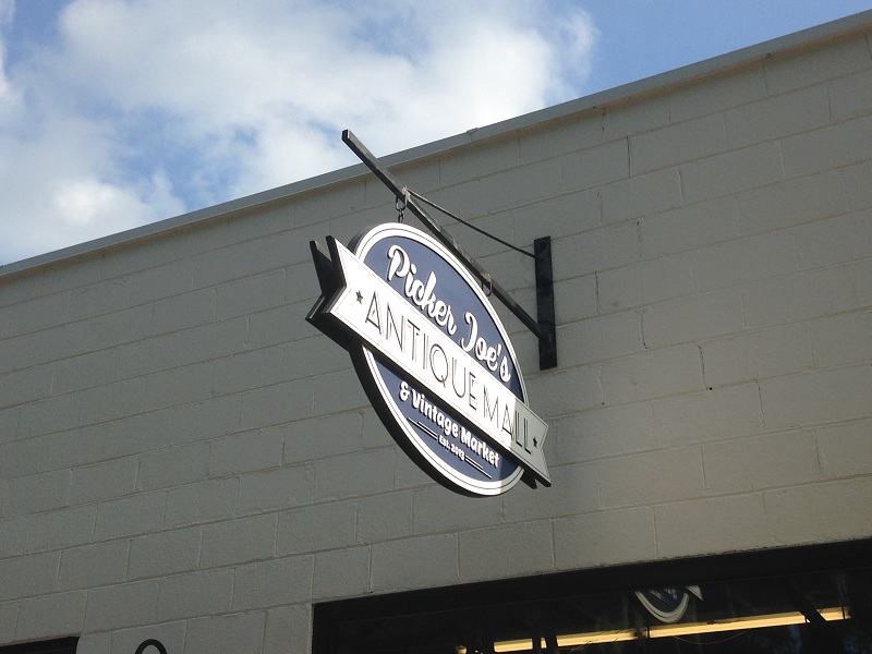

I make all of my hanging sign out of two pieces. I cut a 5/16 grove in the back of the signs and embed 1/4 steel rod bent to a shape of horseshoe with ends bend to eyelet . I use pins and epoxy to join two panel together.
I've done something similar. In my case it was 1/2" PVC and routed a groove in the back of only 1 sign and hung it using aircraft wire through the groove and then just joined the panels back to back. It worked great and was self leveling. then we just slid PVC pipe painted silver over the aircraft wire and mounted using ceiling tile clips. Looks great after 2 years still.
