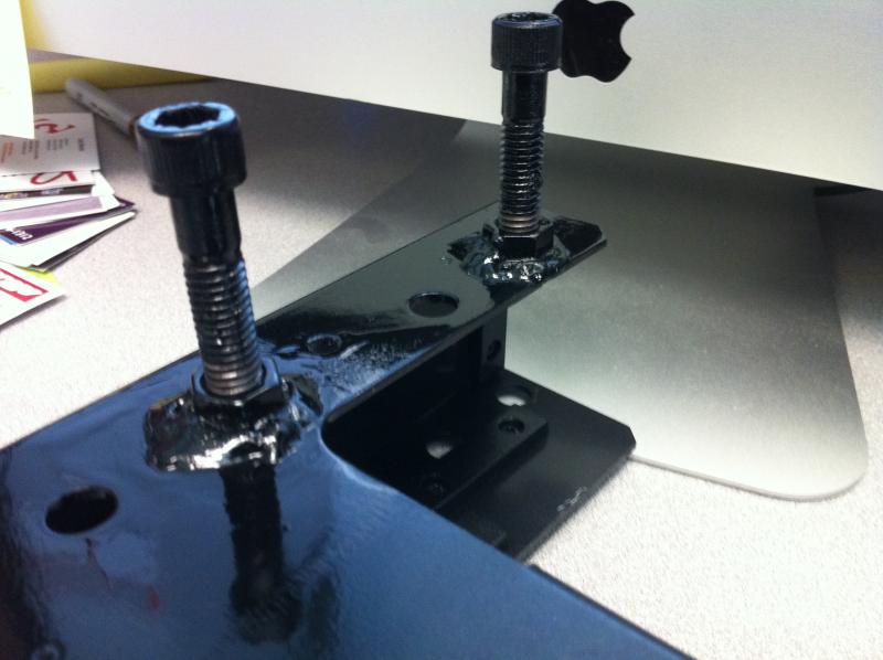

on a roland..... that foresaken takeup reel! i welded 2 nuts on mine so it wouldnt wobble during takeup. the ridiculous 1/8 thumbscrew it comes with is worthless.

I have the same machine as UCMJ22 (Roland XC-540). It only seems to happen to me when running banner material. I only use the two outside pinch rollers, so that the middle ones don't leave tracks. I also use the media clamps to hold the edges down. But it still seems to buckle on the edges, especially if I have a new, heavy roll of banner on there. I do not have a problem with the take up reel, I just make sure to tighten the screw pretty tight.

Well I can see how take up reels can be a problem in the way they work.
I think your right that gravity is probably the best method.
But not practical.
Seems to me two independent wheels pulling on each corner would be better than a single tube.
Course the wheels would need some sort of viscous fluid clutch or something.
