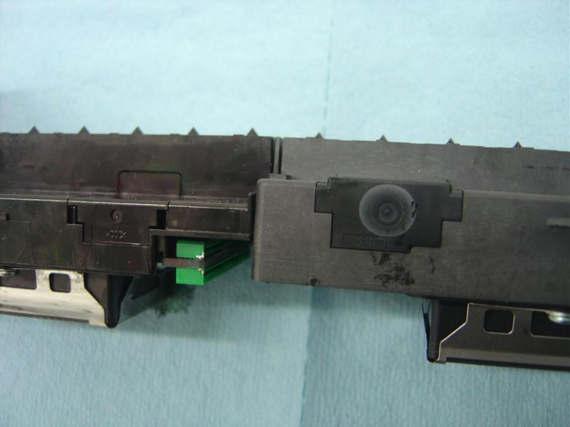

I'm including a pic of the old and new printheads. The new one is on the right.

I had a little issue. I ordered the print head for my 1604, and it turns out that my machine uses the newer print head that is used on the 1614.
So I've now ordered the correct one, and hope to have it on sometime next week.

Just FYI the VJ1204, 1204AS, 1604, 1614, and 1608 are listed as having the same printhead replacement part from Mutoh.
We have only seen one High Heat error, replaced the printhead and it was resolved. I would guess you got a factory defective replacement head or you shorted the head installing it.

You got the wrong head brother.. That won't work or fit properly on your VJ...

The VJ-1204, 1304, 1604, 1614, and 1608 all use the same head. I saw the picture that was posted in the other thread and the problem you are having is you were sent the wrong print head.

Hello Paul:
Mutoh VJ series have many style 1204/ 1604/ 1614/ 1618...
Most of them use different printer head.
Your printer problem is use a wrong printer head.
You say "The new print head came looking the same except the manifold is thicker. The company that I got it from said that the 1614 has a thinner manifold (like mine), but my 1604 should use the thicker one like what they sent. They said I could switch manifolds to make it fit in my machine."
It is the reason of your problem. The printer head main difference of different Mutoh VJ printer is manifold. Printer heads have to use the correct manifold, or they can not set on printer well.
