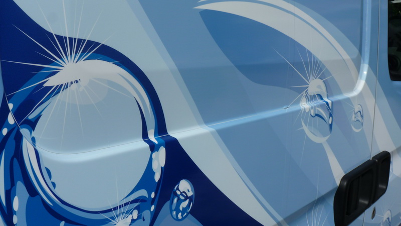

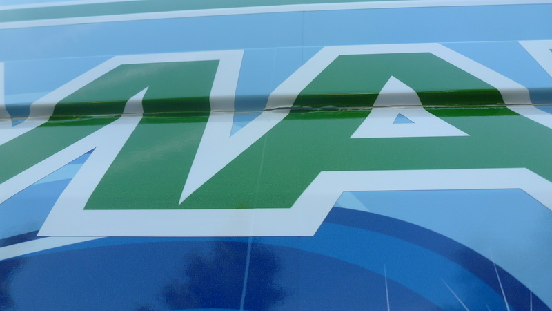

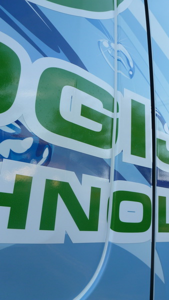

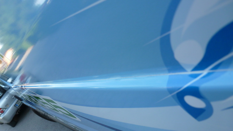

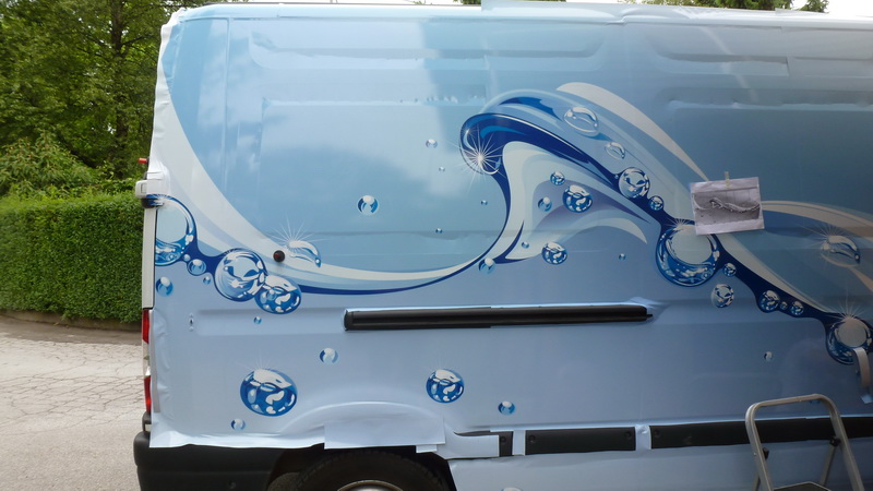

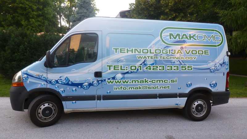

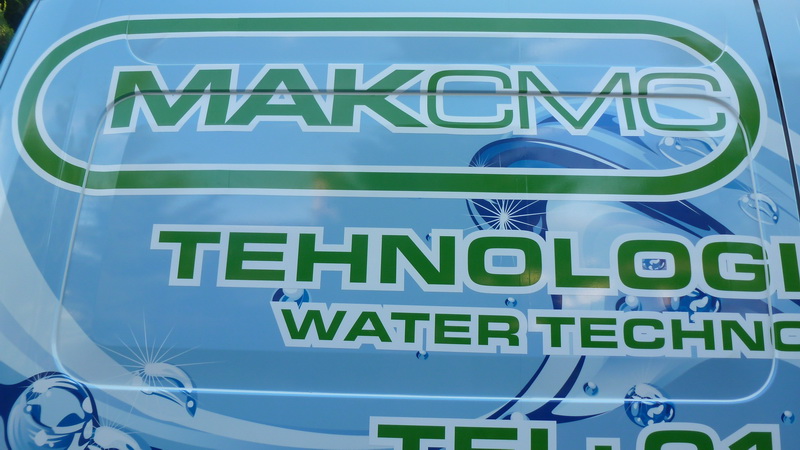

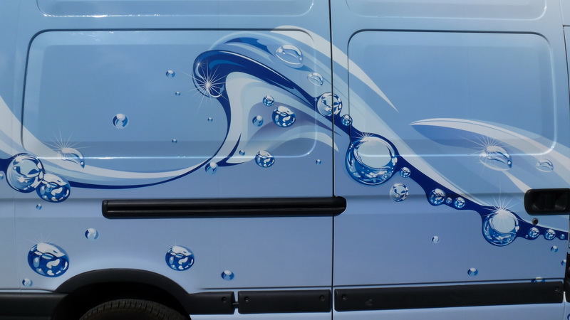

Hello!

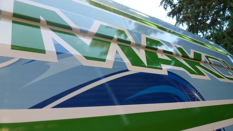

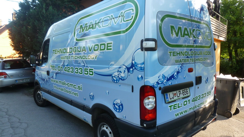

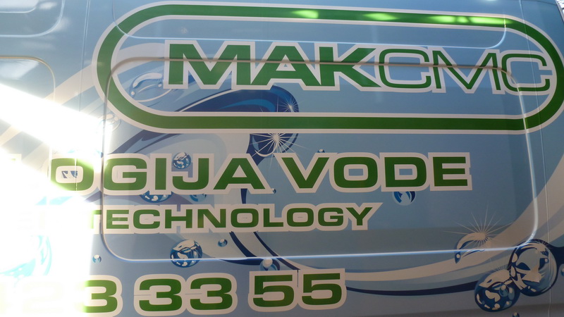

We just did this van wrap. Everything went well, except these corners of seeming windows. When we apply vinyl, we went over them like they would be flat. And then later we heat it up, and get them in right position. But viny was bubbling on whole corner! I could get it to be fix in corner!!! Then we cut line in corners, so that we realease vinyl, but then it come off on some places?! Not to mention, that cut line was very culry, so we cut another line with ruler, and now white line is 3-4mm width, but lines are straight and it doesnt look so bad.
So how in hell do you get vinyl in these window corner??? i saw a lot of vans, where there were same white line in corner, so i think we are not the only one with this problem! But i also saw vans, where there was no white line in corner. Viny was nicely sticked in corner.
Second question:
After installing background, we install other text. Do you charge that extra? Becouse it took some time and material, but the product look much better. We could print text with background, but then it could get off line, somewhere it could go curly... I think it is up to customer, if they are ready to pay more for better product?
but even here we had some problems with these window corner! Where letter line get on background vinly it came off again on some places. For 0,5-1mm. Will it come off more and more, or will it stay that way???
Here are some pictures... (look them in reverse order! :smile:)

jasonx
What material are you using? You should be using IJ380 or a non bubble free cast material from another supplier.
Should have no problems having vinyl stay put in that recess if you reduce the stretch over a larger area which doesn't seem to be a problem with that vehicle.
The recess looks 15mm deep so if you tighten the vinyl to about 150mm from the edge of the recess then heat and apply into the recess you only have a 10% to 15% stretch which would be acceptable.
jasonx
If you had no choice over material and it was a short term material, the proper way would to be apply the vinyl right over the recess. Use the edge of the recess to the cut the vinyl then apply that remaining piece in the recess. You would have a white border with zero chance of failure. The cut would look nice though and you wouldn't touch the paint on the body of the vehicle.
msenjur
we were using oracal 3551 rapidair, and 215 oraguard lam.
ok... yes, we didnt tighten it to 150mm but only around 10mm. And first i strech vinyl in recess, and than i press rest vinyl on flat surface... so that i didnt tighten it in recess on end... hm... that could work, if i would left enough vinyl free.
What about vinyl coming off on edges? it is visible on photo ...383.jpg (last in second row)
msenjur
ok... so we did fine 'till photo ...349 (last one). At this point we should cut out "window", and apply it separetly? But there would defently be a white line!
jasonx
Your problem is of over stretching.
Did you post heat the vinyl after it was applied? I don't use Oracal so don't know their specific temperature.
I'd say that its going to curl back a bit more. If you still have the van make sure that all the vinyl is as flat as you can apply it and then post heat it properly. This should help stop the pvc from wanting to return to its original pre stretched state.
Next time to put the stretch in the vinyl over the largest area to put less stress on the vinyl itself.

I think you have used the wrong material for this wrap.
The 3551 and 215 are both calendered and are not a first choice of material for a vehicle like that. Your materials would work better on large flat sided panel trucks that do not have the complex curves and recessed lines that your van does.
You need to use a cast film and cast laminate to do it properly.
The extra cost of these materials will more than be made up for with easier installations and far less chance of failures in the areas you are having issues with.
Calendered vinyl will try to return to the flat shape it was on the roll leading to lifting even when it has been post heated correctly on the vehicle.

But yes as other said - wrong material for a full wrap. Only thing I'd wrap with a calendered vinyl would be a flat box. We use 3M 180 CV3 for most wraps but where something has extreme contoured curves or extreme recesses like those on a Sprinter we also will use some 3M 380 for those areas.

Wrong material like the others said. The tenting will only get worse.
Wrap the sucker again and take the loss. Good lesson learned.
That type of material cannot be stretched, or conform to the body like your trying to do.
3551 is for flat surfaces.

Now way around it, you used the WRONG materials for this type of wrap!
Oracal 3551RA is for general signage and vehicle wraps over simple to moderate curves,
http://www.oracal.com/products/product.asp?seriesID=225
Should have used ORAJET 3951RA cast construction for highly conformable performance over the most difficult curves, corrugations, and rivets.
http://www.oracal.com/products/product.asp?seriesID=230
I strongly suggest, you remove this wrap and re-wrap with the correct material, these tents and bubbles are only going to get WORSE.
