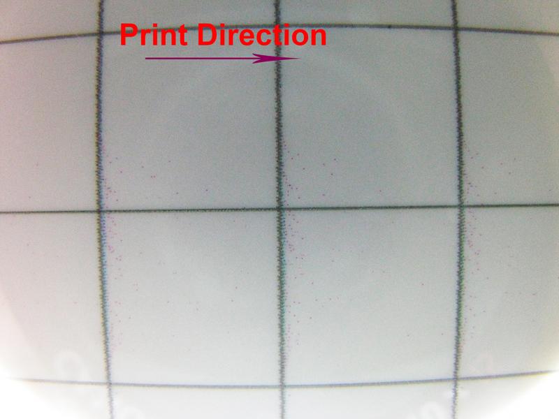

Once the profiler has finished im going to do just that. Trying to check if its due to ink limits for now. If the issue hasnt been cleared I will shoot the grid through and check.
Gee artbot... thanks for the guidance mate. You're a star!
300 x 600, no colour profile, no extract, unidirectional grid as you said. As raw as I could get it. The print is consistent on the x axis however magenta is all over the place every 10mm on the vertical lines. Whether nozzles are firing or not, it seems consistent, just random for magenta on the y axis.
What am I looking for exactly artbot?
