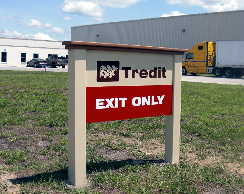

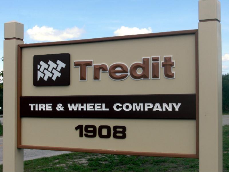

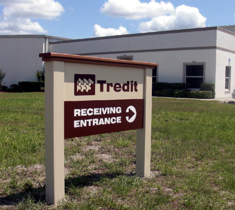

Just returned from installing these three signs. Nothing over the top but classy none the less. All PVC and DiBond for the faces. For the first time, I used Trex decking material to make the caps on the smaller signs and for framing in the larger panel. Not sure if I like it or not yet. Will have to see how it stands up to the test of time...

Excellent again Bob! I've built many decks out of Trex and never had a problem with cupping. It does fade over a long time but everything does eventually.
SignManiac

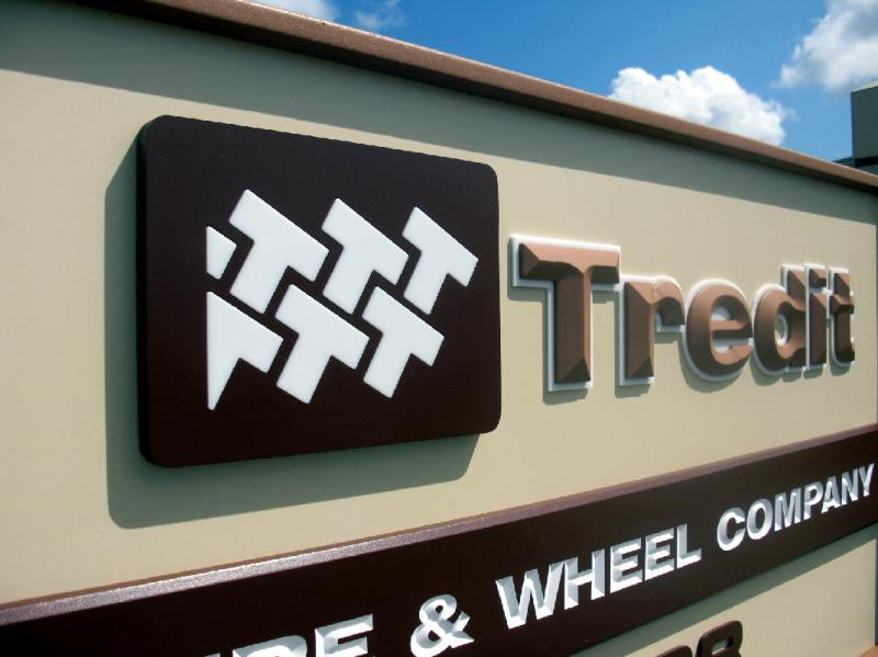

Thanks guys. The Trex is painted so not so worried about fading and John answered my concerns about possible warping. I cut an inset 1/8" x 3/8" dado into the edge of the Trex and locked the DiBond into it on all four side after mitering the outside corners, so it's locked into a frame or sorts.
The logo is 3/16" white acrylic inlaid into the PVC rectangle. and the white backing of the name is also the same acrylic.
