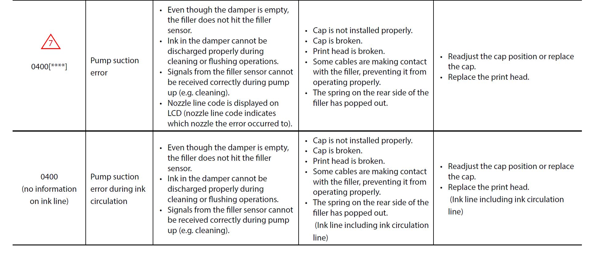

Jim Hancock
Old School Technician
See attached for details. It looks like you may need a good Roland tech to come in.

0400 errors are a problem between the damper and waste ink tank, including possibly the damper fill sensor. I would start by replacing the cap tops. As long as that printer was sitting though, especially with the original TR inks - which dry very fast, you're likely going to need heads and dampers along with the cap tops at a minimum, but very likely, you'll need a new ink system - Ink lines, pumps, valves, etc. Also, check the dates on the ink bags. If they are over 2 years old, you'll want to flush the entire system before replacing the print heads and dampers if you don't replace the ink lines.
