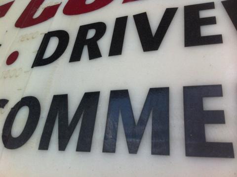

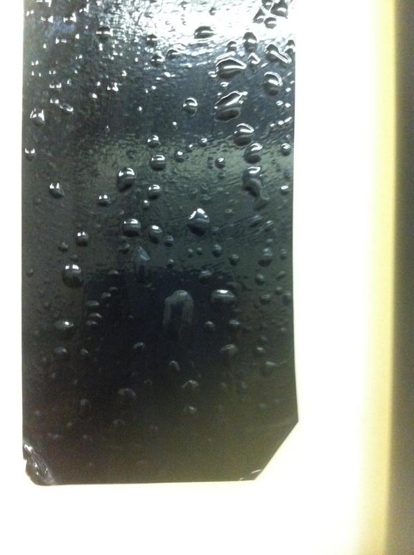

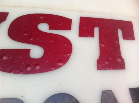

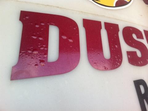

I have a customer who wants some vinyl installed on a 3000+ gal polyethylene tank, one tank was new last fall and the other is new last week. He had another company Install the vinyl last year and the attached pictures are what happened the next day. Tank was empty and brand new at the time. Anyone ever have this happen before, if so what Vinyl should be used so it does not happen again. The Black Vinyl was fine only the maroon vinyl that was affected.

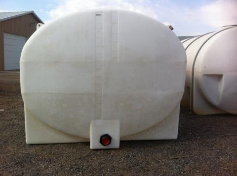

So I Installed some test pieces to the tanks, and good thing I did because the result I got is surprising to me.
Oracal 751 - Bubbles
Oracal 651 - Bubbles
Fellers House brand ShineRite - No Bubbles!
Talked to customer and that is what he wants to go with. (I know its not the ideal material to use but customer is well aware of the durability and if he gets over a year he is happy)
This is the 751 that has been installed less than a month and already bubbling like crazy
