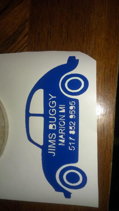

I have a customer that would like me to cut him some decals for his business, he had sent me a rough idea of what he wanted so I laid it out and tried to cut it out, as you can see the lettering is too small and doesn't weed very well and isn't going to stick very well either.
Any suggestions would be appreciated

increase the QTY and have someone hot stamp them,
NOTE; printing to clear is great but be warned that if they are applied to glass it will become transparent unless there is a white backing

Try a different font for the text. Other then that print on White or Clear.
What kind of cutter and software are you using? In your picture, none of the cuts seems to line up from what I can see.
Edit: In the picture, the artwork looks very raged. Did you convert his jpg or is that the original vector file?

Even if they wanted white text still this would be the best option. Print on clear. Apply White to the back. Reload on plotter and cut the contour out.

You can always cut the info out in white and overly the white in place, Dont know what cutter you have, but you can try slowing the cutter down and make sure your blade isnt dull

Outsource it for Gerber Edge print and cut production. This kind of job is what the Gerber Edge does best.

The real question here is WTF are you plotting this with? A dull spoon?
This is a job for a Gerber Edge; print the blue on white or clear.

3M 7725 vinyl will make this a relatively easy cut job... I always keep white and black in stock, but you can get it in colours too!!

Find someone to print them and do a contourcut around it.

some more off topic, that graphic is bad and needs to have some editing done to clean it up. just out of personal pride, I'd never cut that as is and would fix those lines

Yeah, that graphic is badly in need of cleaning up.
If Fred is too busy, I have an Edge and would be more than happy to print them and clean up the art for you.
