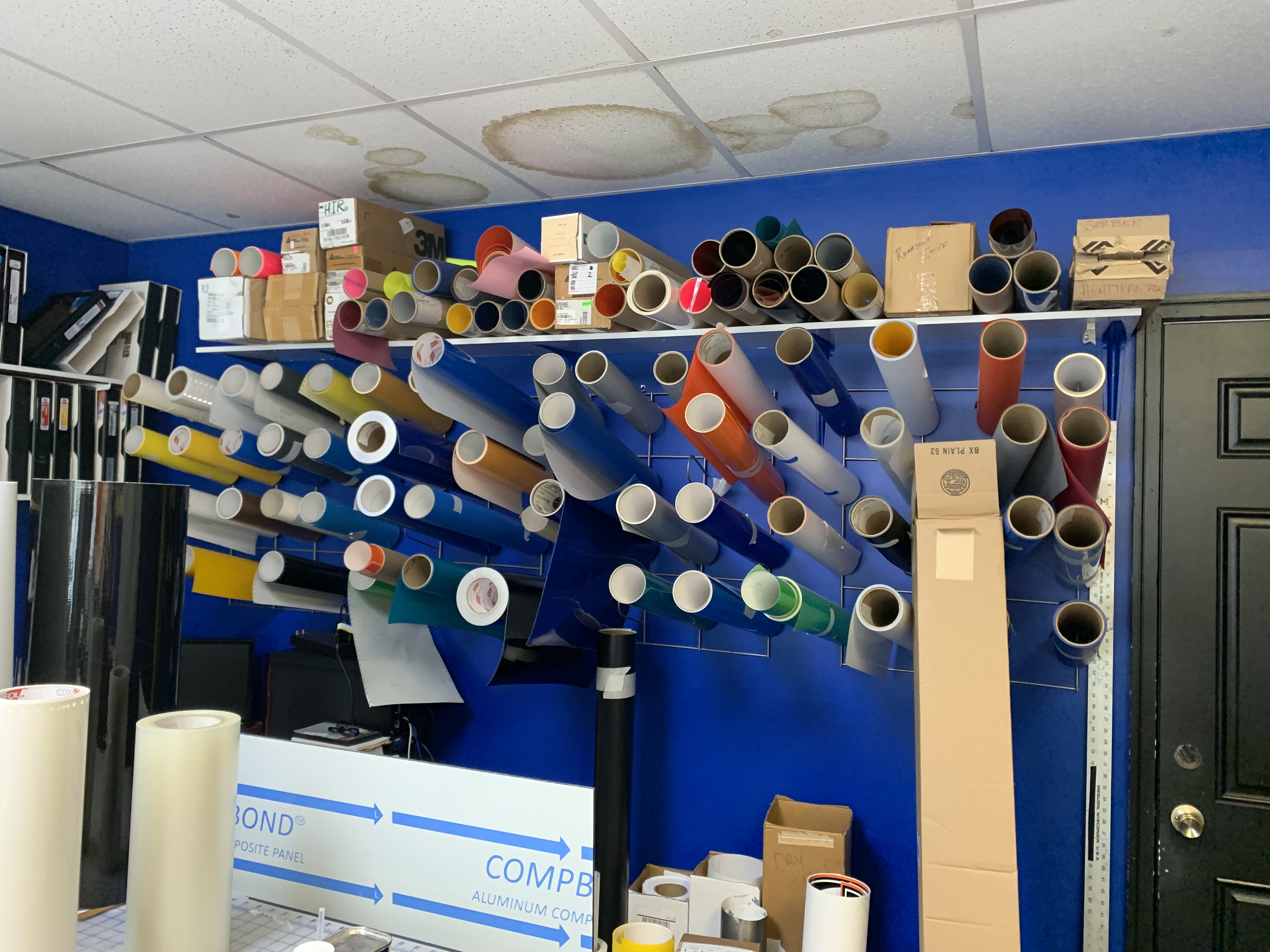

We are expanding to a new space next to our current shop and I am looking for ideas for vinyl and laminate roll storage. We probably have close to 100 rolls ranging from 15" to 63" and I am hoping to set up this new space differently than our old space. Our old space has floor racks. Effective, but takes up a ton of floor space.
Has anyone ever used a horizontal wall rack system like the one attached? Seems like a good way to limit storage space, but not sure if someone knows of anyone who sells something like this or has built it themselves? I'm sure we can figure it out, but thought I'd tap in to the super knowledge base on 101 first. Thank you.

I feel like you need to be a giant to reach those top rolls... That's roughly 50 lbs and way above my head. We use a system similarly to the one on the right. You take up 5 ft of floor space... But you can stack 20ish rolls high for every 6" x 5 ft space. All the bareilly used ones good near the floor or head height while the most used go in the perfect - non back breaking sliding positions.

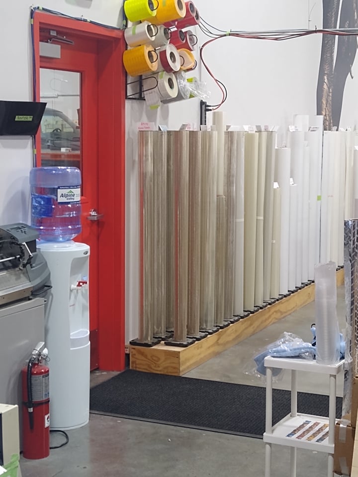

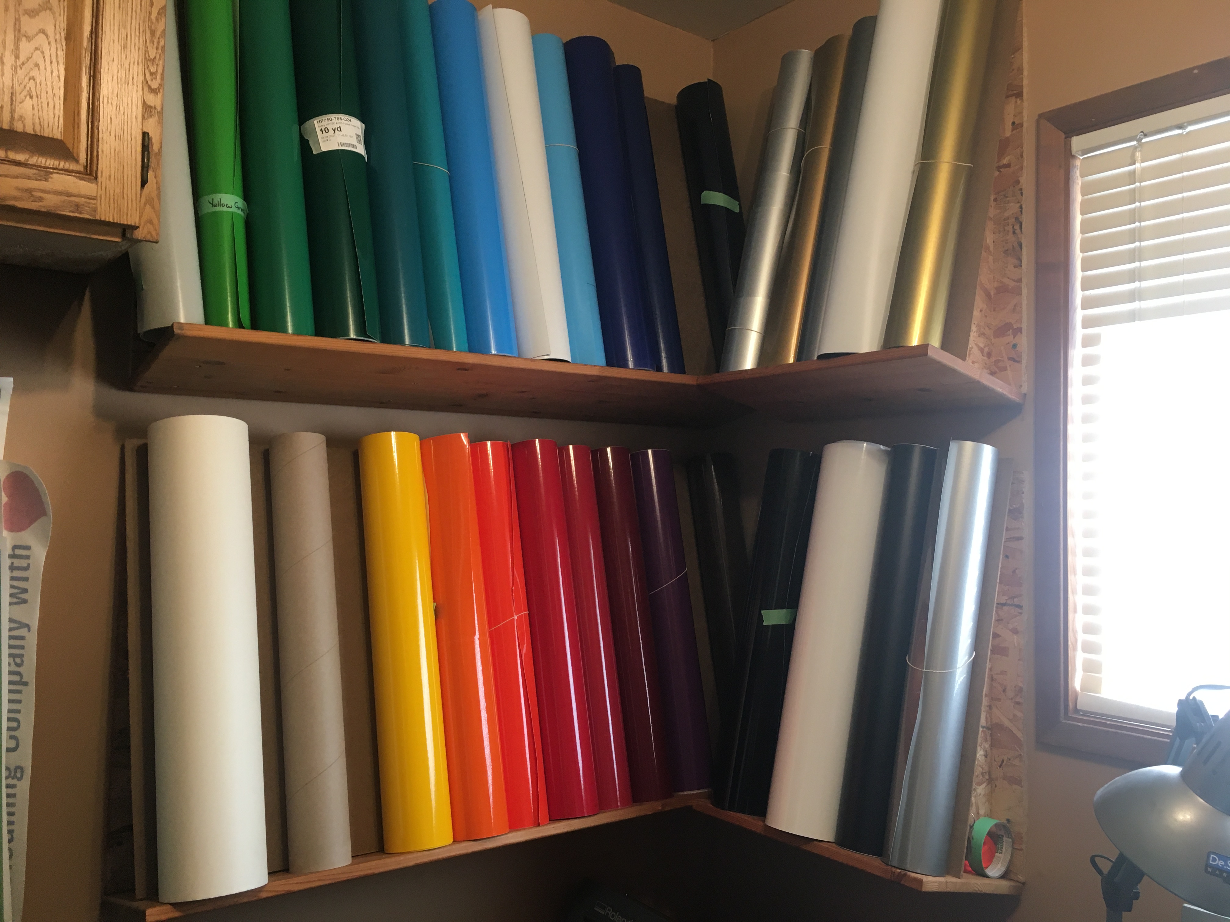

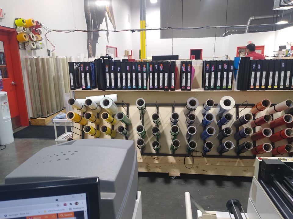

We store our 30"+ print/laminates along the walls on the plastic end caps; laminates near laminator, print media near printers. We store the 15" vinyl for the Edge on a rolling rack near those printers.
We do use the wire frame rolling racks to store the 60" 2080 materials on.

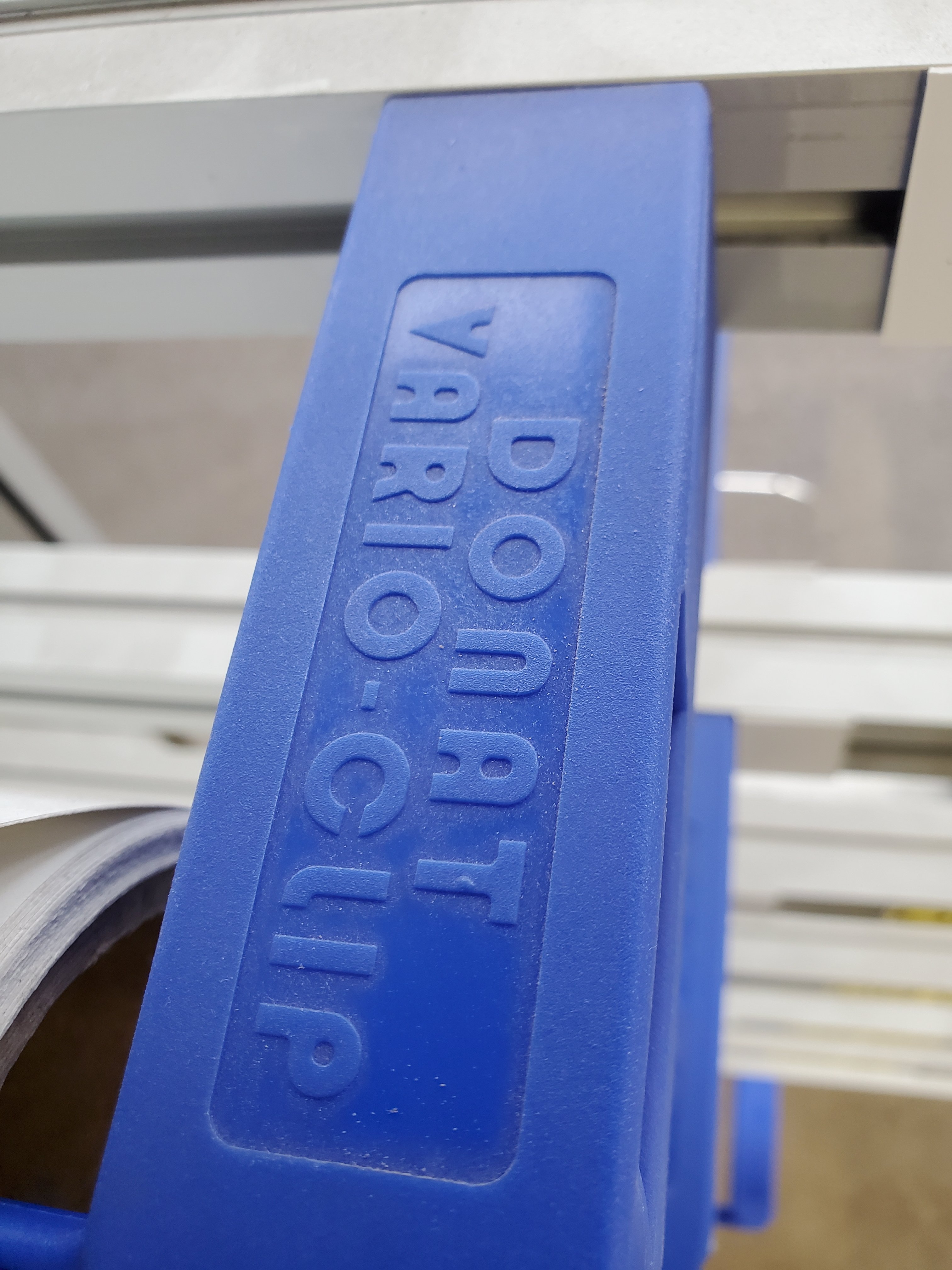

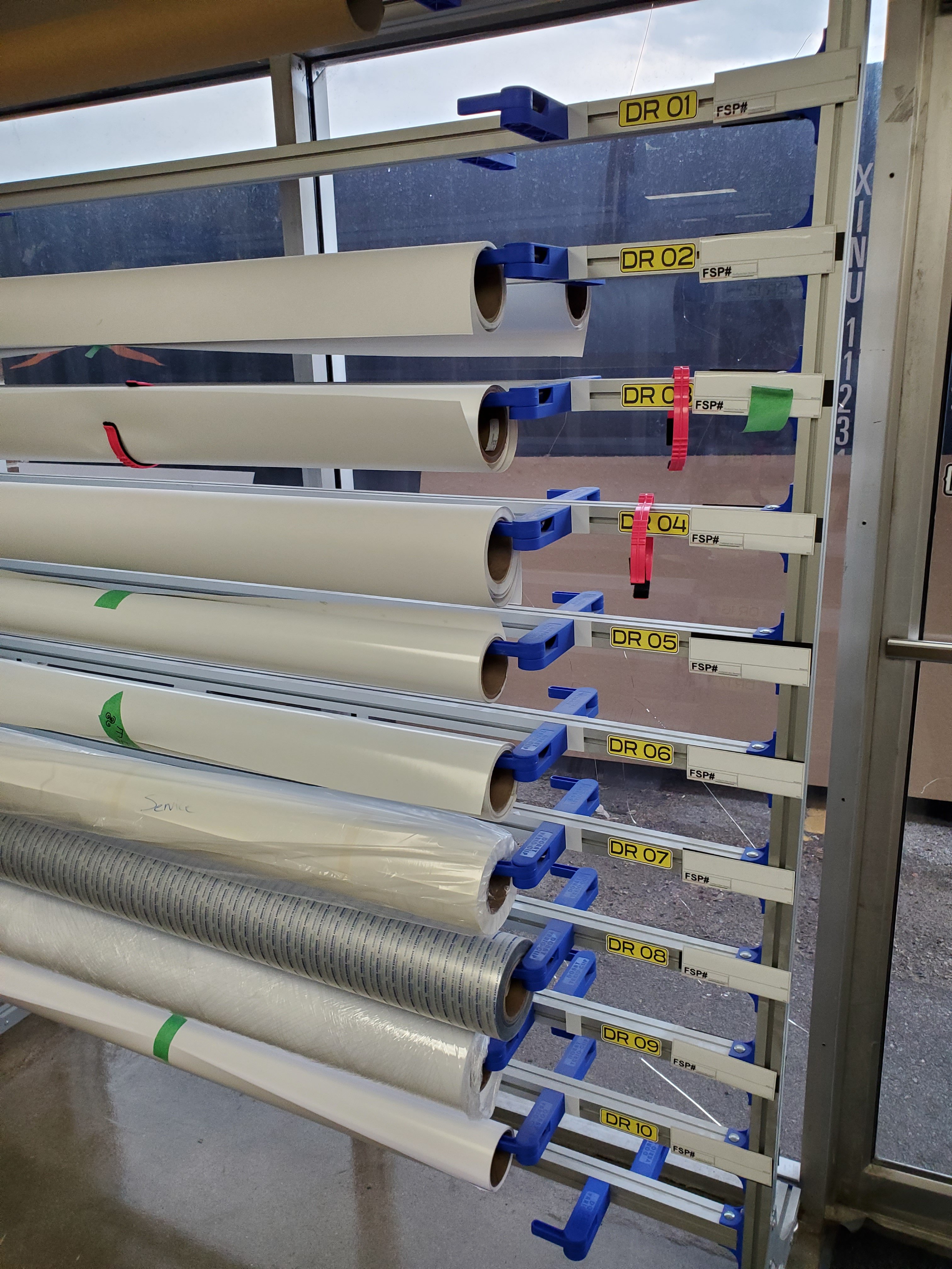

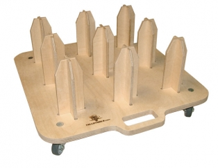

We bought one of these systems at the SGIA show several years back. Love the system, but it's very hard to find here in the states. You take the rolls right on and off, no need to pull a 60" rod out of the middle of it. And NO, we have never had one break. You would think they would, but they are very sturdy.

I made our own that are similar to the yellow tool ones. 1 piece of 2x2’ 3/4” plywood. 4 harbor freight casters and then I made our posts from 2x3” studs. I think about 6” long. We fit 9 rolls and can slide the whole thing out of the way or spin it to get to a back roll. I made 2 and need to make a 3rd. We only store 30” at the most though. Works better than the plastic ends that the media comes on.
Very nice setup
View attachment 154129 View attachment 154128
That is a VERY cool system.

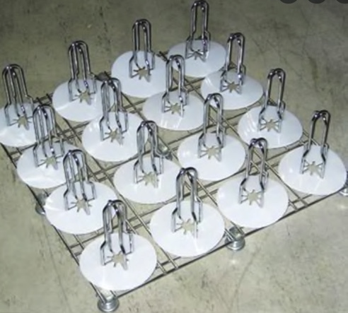

Thank you all for your responses. We already have (7) of these 16 roll floor racks. They work well, but we have about (25) stray rolls standing domino style and they do tumble. Trying to save floor space, thus wanting the wall racks. The dust thing makes a ton of sense. Would need a good solution for that, so we don't have to bag the rolls.

We also have the bent wire type you posted a photo of... and we have zero rolls on them because they are utter garbage. Yes, vinyl will domino when it's bumped. The YelloTools ones are 1000x better as the center piece of wood goes further into the roll and isn't tapered like the wire ones are.

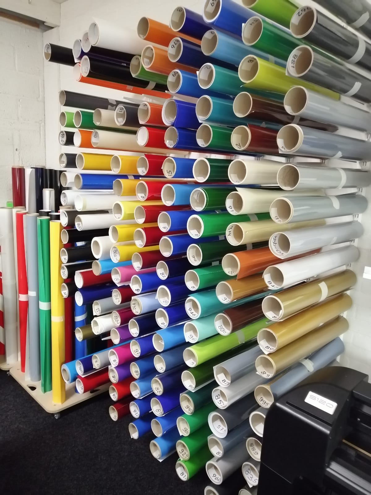

Spur rails on the wall for the 61cm rolls, bigger rols on Yellotools.

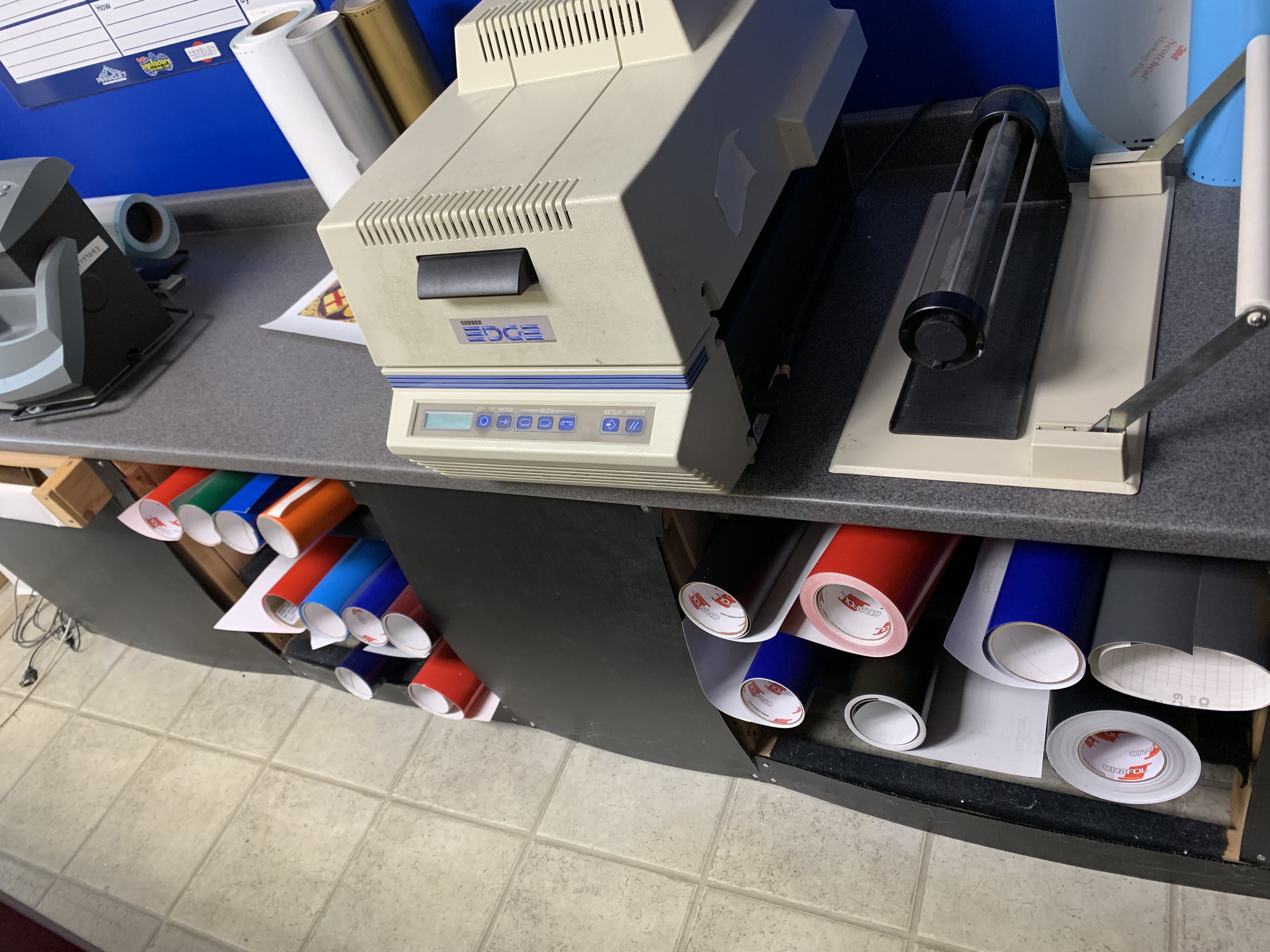

I've done storage so many different ways. Currently, I have some of the wall racks that I put my 15" rolls on as well as my 24" rolls that are being held for a current project. I also have one rack that's dedicated to my heat transfer material. Then I have a counted that the Edge and 15" plotter sit on and there are two horizontal storage areas under that. Both of these are shown in the attached (ignore the clutter that is my current work space).
Then in the far back end of my shop area, I have an old counter (built circa 1989) that served as the original welcoming counter and the entire bottom of that is horizontal storage for 15" rolls and the spots are even labeled for the colors.

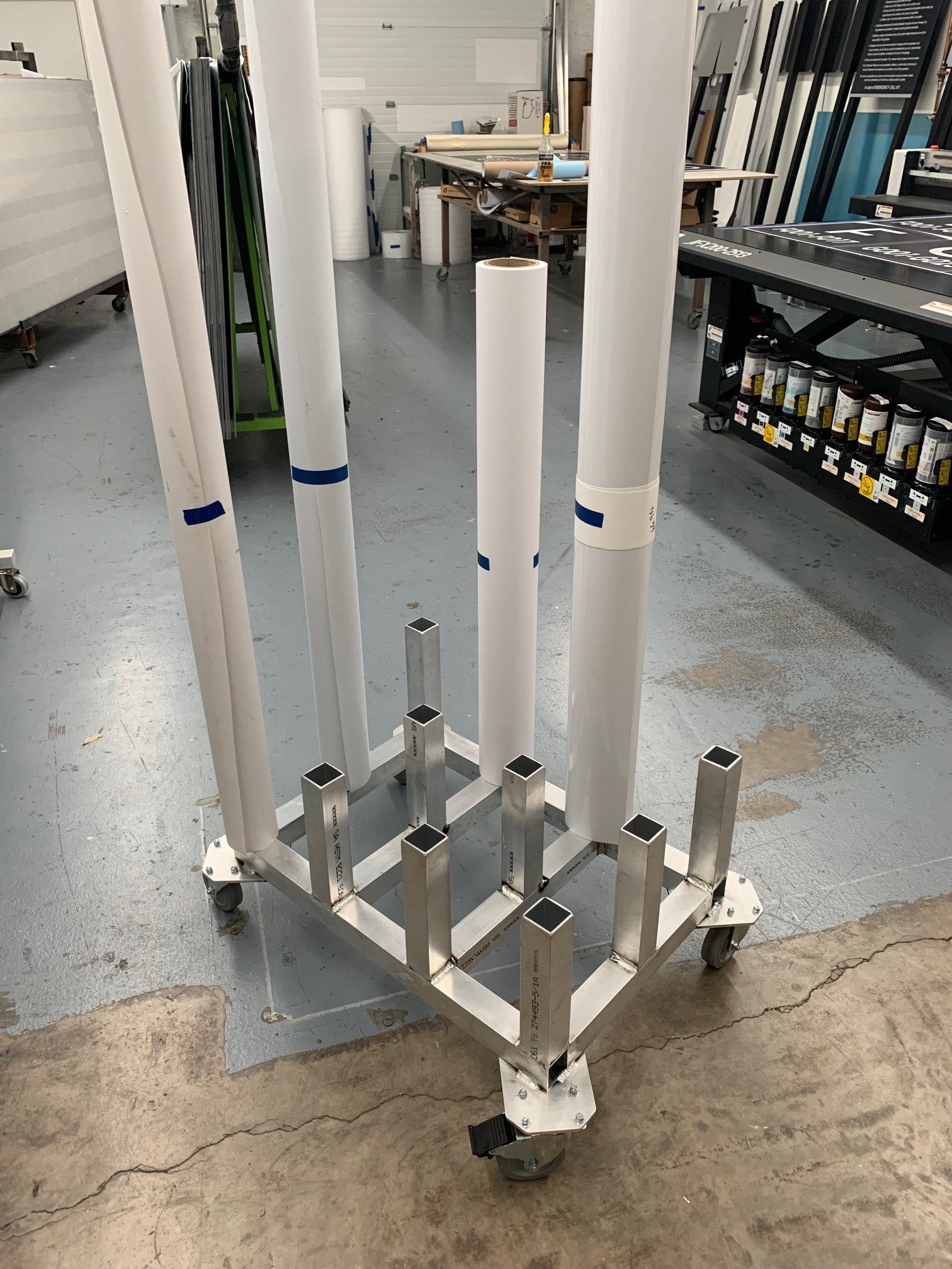

Here is pic of the type of carts we have made for our print shop area. I like being able to roll the carts around where ever you need them and then push them in a corner for more room lol. We do alot of aluminum fab so using some drops from jobs is easy. Put on some good casters and these things will last forever.
