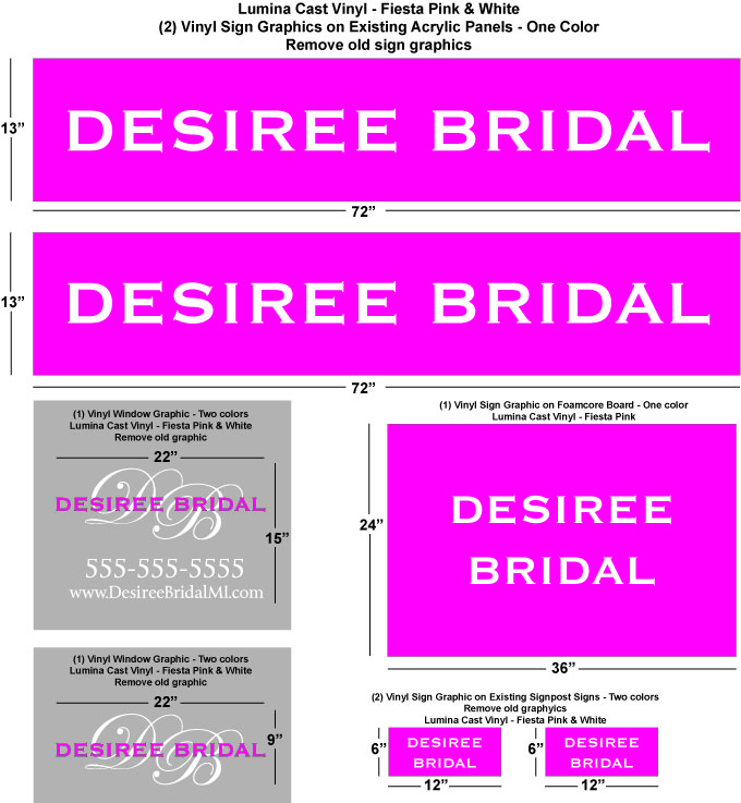

We are brand new to the group. We do promotional products, but have been doing some smaller scale sign and graphics work, mostly for friends and family. We have a job we are trying to work out for pricing, so any help would be appreciated, and I will try to attach a picture for reference. The material will be Lumina Cast 2100 Series, in Fiesta Pink and white. Old graphics will need to be removed from the 2 roadside sign sides, the 2 door window graphics, and from the 2 sign post signs. The project entails:
(2) Sign sides for a roadside sign @ 13" x 72"
(2) Glass door window graphics, 1 @ 15" x 22", and the other @ 9" x 22"
(1) Sign on foamcore board @ 24" x 36"
(2) Sign post graphics @ 6" x 12"
Thank you for the input.
~Paul

(2) Sign sides for a roadside sign @ 13" x 72" $460.00 would do it on acm and place over old signage or $550.00 if removing old
(2) Glass door window graphics, 1 @ 15" x 22", and the other @ 9" x 22" $200.00 with removal of old
(1) Sign on foamcore board @ 24" x 36" $220.00 but would do it on 1/8" pvc
(2) Sign post graphics @ 6" x 12" $60.00 place on acm

Somewhere around $1,500 to $2,000 depending on the conditions.

I'd be pretty close to what Visual800 posted above.

I really appreciate the replies, both with some help on pricing and overall guidance. I will make some adjustments to this, but this was my first run through before having any pricing help like Visual800 provided:
(2) Sign sides for a roadside sign @ 13" x 72" $450
(2) Glass door window graphics, 1 @ 15" x 22", and the other @ 9" x 22" $250
(1) Sign on foamcore board @ 24" x 36" $150
(2) Sign post graphics @ 6" x 12" $125
___________________________________________________________________________________
Total Estimate: $ 975.00
Labor was estimated at 9 hours @50 = $450.00
Material Costs (No overhead or profit): 1 Roll of Lumina 2100 Fiesta Pink $97.99 (Special color, entire roll) = $97.99
.33 Roll of Lumina 2100 White $90.98 (Partial Roll used) = $30.02
Misc. Shop Supplies (Appl. Tape, Cleaners, Tac) = $50.00
Overhead, Cutter Usage, Markup and Profit = $346.99
Total = $975.00
