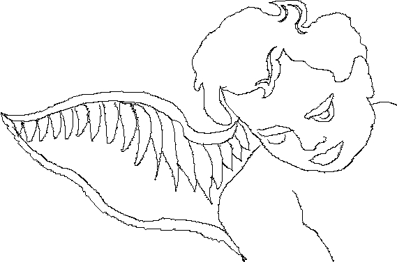

Please dont laugh!
I just fot a 9-12 wacom tablet, and am trying to do some illustration work.
What I'm really having a hard time doing, is getting a smooth flowing line. Now I know I can go back, and edit all the curves etc., but this is just extremely time consuming as there are thousands of nodes being created.
So, is there a way to create less nodes etc., or am I screwed?
The attached picture is just the initial layout,, very rough.

Hey Z
What software are you using? I use a tablet all the time and never get lines that look that rough. I'm in Corel 13.

Must be some setting you need to adjust. I use a Wacom tablet exclusively. That looks more like an autotrace from a very jaggy bmp file. If you use the pen tool (not pencil) that would not create so many points. The pencil tool in Illustrator could look like this if you did not adjust smoothness or you had severe hand shakes

Zeth, What tool are you using in Illustrator? paintbrush? pen? have you set your application settings for Illustrator exclusively in the Wacom preferences to cater to the way you work?

Doesn't matter if your using the pencil or brush in Illustrator.
Double click on the icon in the tool panel, the preferences for that tool will pop-up. Adjust the fidelity and smoothness 'till you get just as you like it.
It takes a few trials to get just the way you like it.

That was the point of asking. If he did not change the defaults and kept it how it is the fidelity for the paint brush is 4-4.5 while the pencil is only 2-2.5.

I figured it out, thanks guys!
