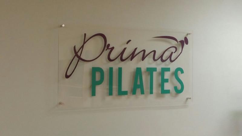

Ultimate13
We gave up trying to install wall graphics unless it is a wrap with Phototex or 3M, the new paints and the amount of different textures make it a headache. This was our solution and will be for anyone that asks. 1/4" acrylic with standoffs in the corners. This one is 4' x 2' and went up beautifully, not a ton more money and the perceived value is way more for the customer. Also goes up in minutes so the on site time is quick.

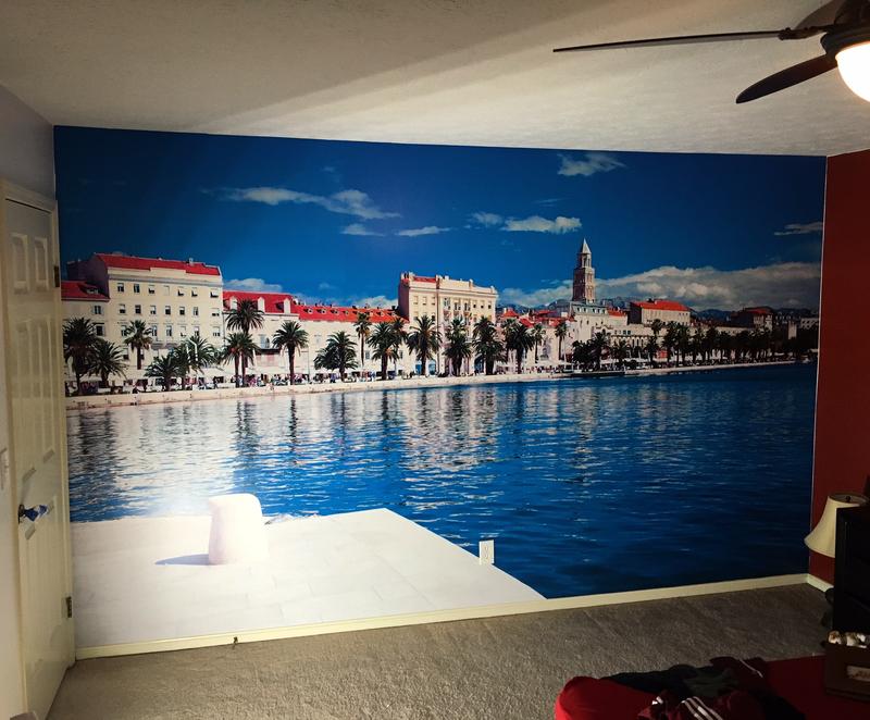

Dennis422
Here is the project I did 2 weeks ago.
Orafol 3628 wall mural film on a latex paint wall. Went on smooth with no issues and no peeling off at all.
If the wall is smooth and paint is completely cured/outgassed, there should be any issues with a decent films.
