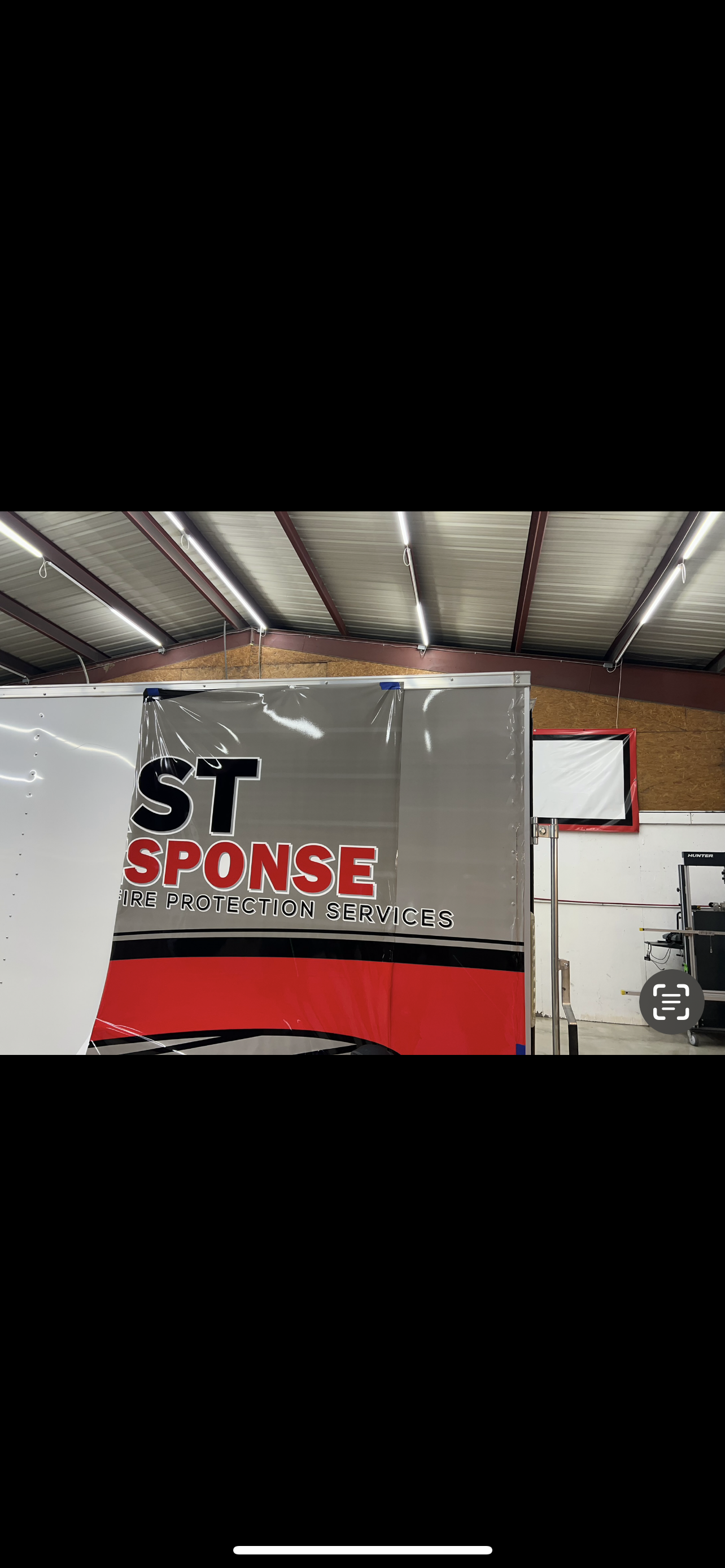

My experience has cost me thousands. Here’s what happened.
My name is Caleb Wilson, and I own a successful wrap shop in Southern California, Rapid Wraps. About a year ago, I purchased a Roland VG3-640 through Montroy Sign Supply. I was originally going to buy an Epson, but was convinced that the Roland VG was the top choice—especially for vibrant greens, which I would use commonly for a great customer of ours, Monster Energy.
Big mistake.
By the third wrap printed, I was already dealing with severe banding issues. Montroy's techs came out and temporarily fixed it, but the issue kept coming back. Then came the color inconsistencies, unreliable output, and the absolute nightmare that is VersaWorks, which takes 4–5x longer to RIP files compared to Onyx. For wrap shops that deal with multi-panel files, this completely kills productivity.
Montroy has been helpful, but Roland’s support has been horrendous. No urgency, no accountability, and no real fixes. After wasting thousands in materials and hours of labor, I stopped using the printer altogether and went back to my HP 560 latex machines, which have been rock solid.
Montroy eventually offered to swap the printer for the “Newest and Geatest” TrueVIS XP-640, a generous offer where they ate a $5K difference. I only paid for the new inks. I agreed to try again.
Same exact issues.
  • Constant banding
  • Even worse color inconsistency
  • Nothing stayed calibrated
  • Again, weeks of downtime, reprints, and lost trust with clients
A Roland tech came out, aligned the machine, and reprofiled colors—it printed great while he printed his own samples. As soon as I printed any wrap again, we were back to where we were before. My shop is climate-controlled, immaculately clean, and we follow every maintenance step by the book. We also shake the ink pouches daily as they are indicating this is necessary for consistent color. The problem isn't the environment. It's Roland’s equipment and lack of quality control.

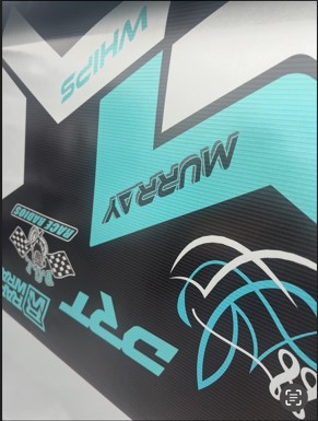

Thanks for the response, Gino — and I appreciate you not assuming I’m just here to bash a brand. Like you, I’m not usually one to post stuff like this publicly, but after 8+ months of trying to get a working solution, I felt like I owed it to other shop owners to speak up.
The photo I posted was just one example — the banding happened in multiple colors, especially cyan and green. That first printer didn’t hold calibration, and even after they swapped it for the new VG3 (which included light black and improved the grays), the same issues continued. The new unit showed promise, but only when printing Roland DG Library colors — anything else came out inconsistent.
I've tried different RIPs, profiles, computers, and workflows. I’ve followed every maintenance step. My HP 560s run circles around it in reliability and print quality.
I do want to be clear that my dealer (Montroy) has actually been solid. They tried hard to make it right. But Roland’s lack of follow-through is what killed it — 7 weeks waiting on promised profiles, a dryer, ink... nothing delivered, and zero communication.
