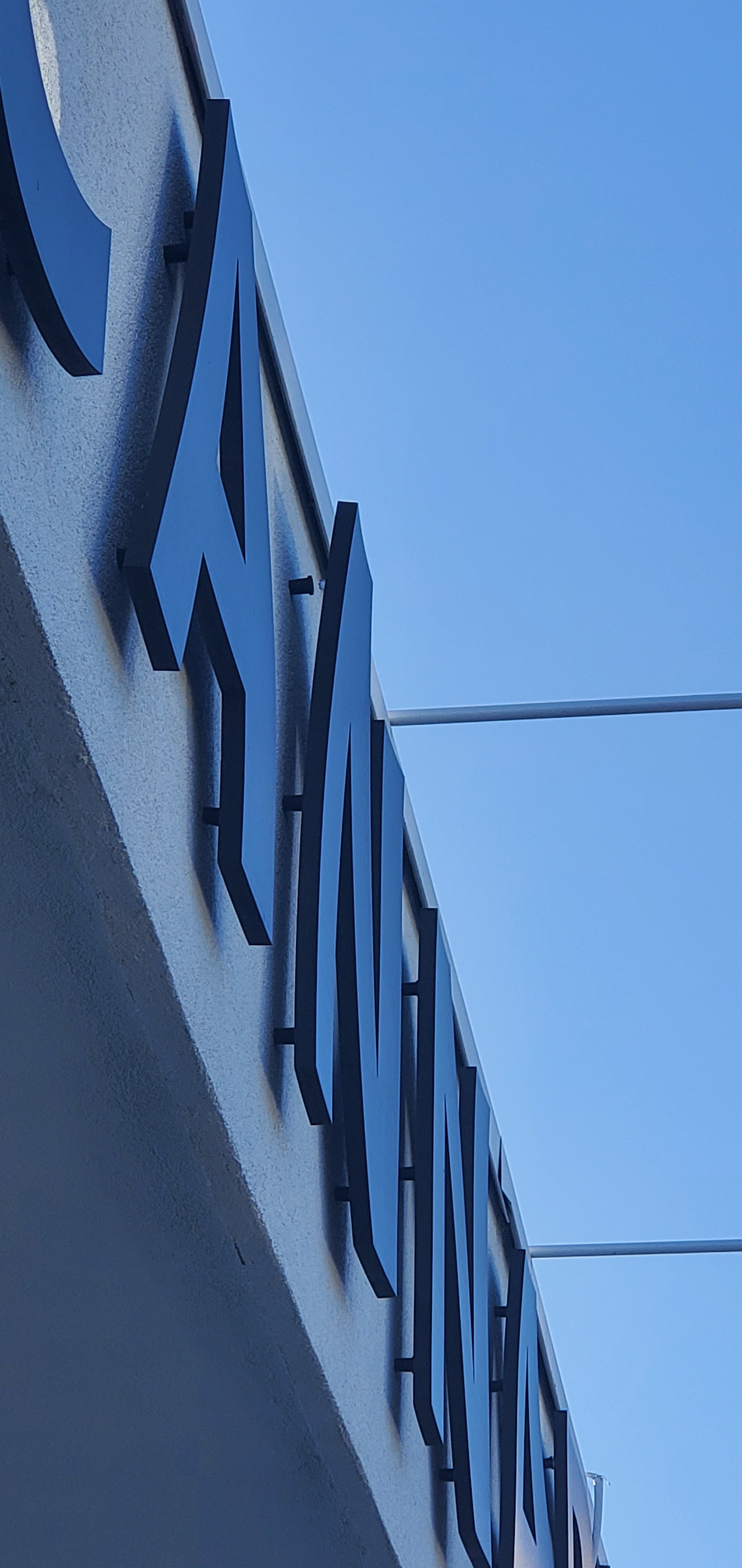

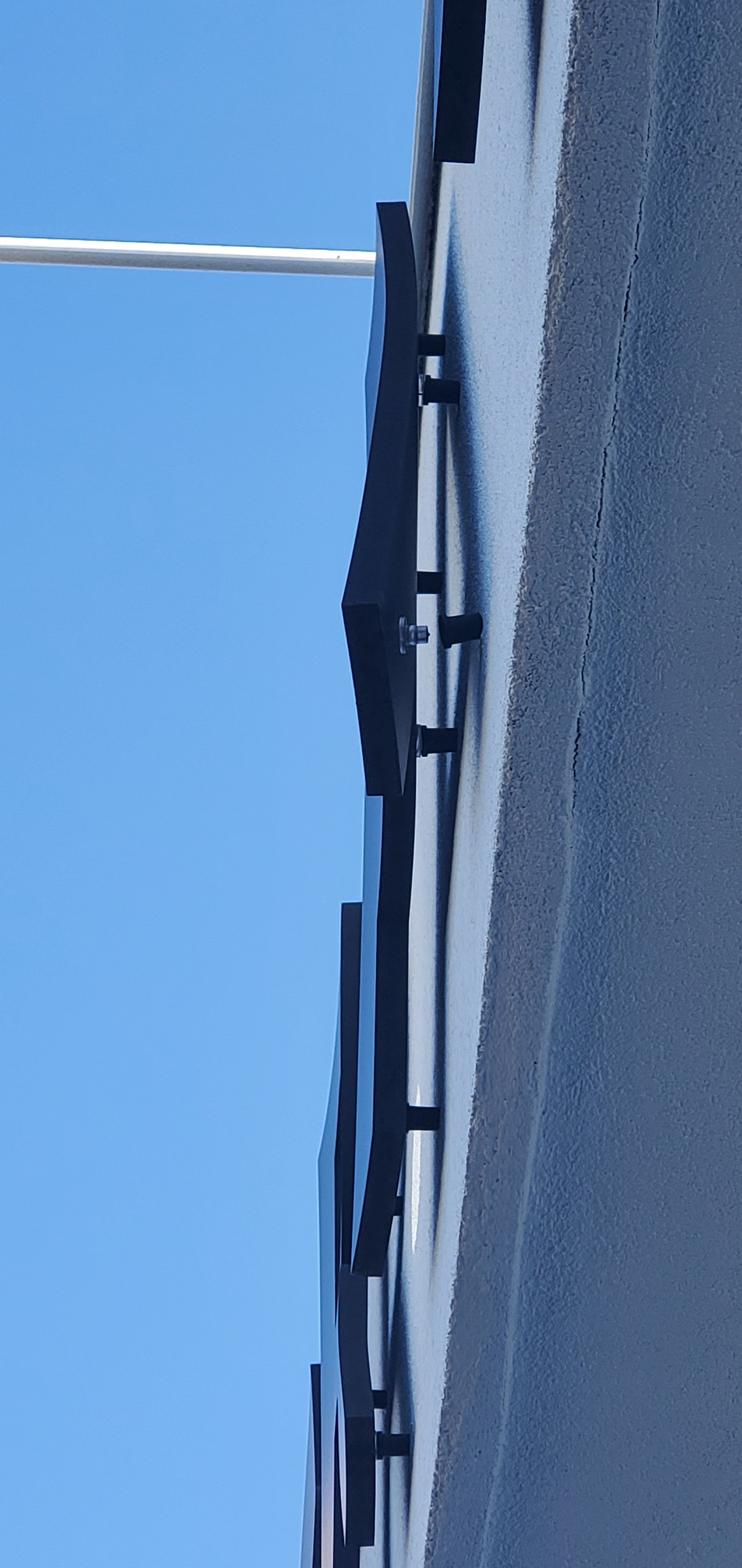

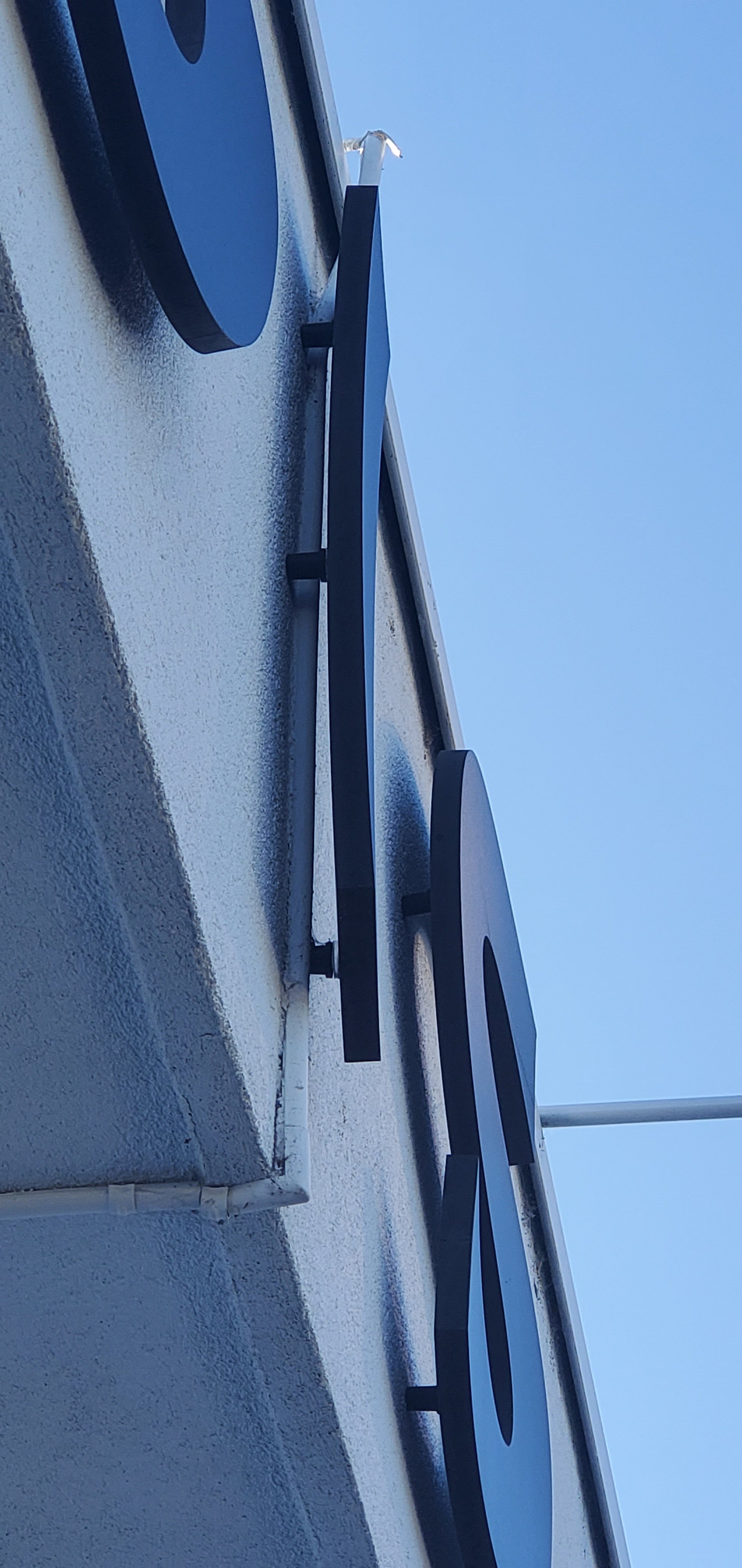

I used 19mm (3/4") black PVC for this dimensional sign on a west facing wall with no overhang. We are not quite a year after installation and I have this major warping going on.. So much that it is popping the letters out of the standoffs. Has anyone had this happen?? I have used this same technique in the past and not had this problem. Material distributer claims that if the edges are not sealed that water could do this... but I am skeptical.
I need help figuring out A) what would cause this and
B) any tips for fixing the existing sign without having to completely replace.
Thank You!

Of all colors, black will hold the most heat.
Black pvc is really not the correct substrate for a situation like this..... in fact pvc is not the correct substrate of any color like this.
If you wait any longer, they might start to go back to somewhat straight again with cold coming on, but it will just start all over again next spring/summer.
You need to use a better exterior substrate.
If your 'material distributor' knew how this was gonna be used, he/she is at fault for not warning you, but it's hard to balme them, when you're the professional.
gnubler
I think you'll have to replace with acrylic, or metal if the budget allows. Bummer.

Ah yes, thank you Gino for your professional input on this. The fine folks here at Signs101 can always count on you for your kind words of encouragement, uplifting attitude and extensive knowledge base.
MikePro
i'd guess uneven exposures & thermal expansions working against the mounting points and flexing itself around over time ...similiar to cramming an acrylic panel into a tight cabinet retainer.
Never had an issue with painted sintra/komatex/expandedfoamPVC lettering. Our main issue has been guaranteed discoloration when unpainted but I've had studded flush-mounted panels warp at the ends in the past.
Big fan of plate lettering, but we'll never shy-away from PVC outdoors to save our clients a buck.

Ive used .75 pvc for applications BUT never NEVER use black pvc, painted black is fine however since your letters are "off" the wall I would have used HDU or 1" pvc

That was actually fairly tame by Gino's standards, but he is correct, PVC is not an outdoor material, even if some claim to have had no issues. The PVC we get in this industry is "foamed PVC" which has tiny air pockets throughout it to cut down on weight and cost, the air in these pockets expand and shrink with hot/cold cycles and cause this warping.
AKA TRE
Thank You! I appreciate the feedback. I will be definitely not be using black PVC for any exterior lettering in the future. Been making signs for 3 years and still have a lot to learn. Went with this method only due to the customers budget and the fact that the previous shop I worked for used it all the time outside... although I am not sure how those are holding up these days. Lesson learned! Thanks for taking the time to explain the "why" part.

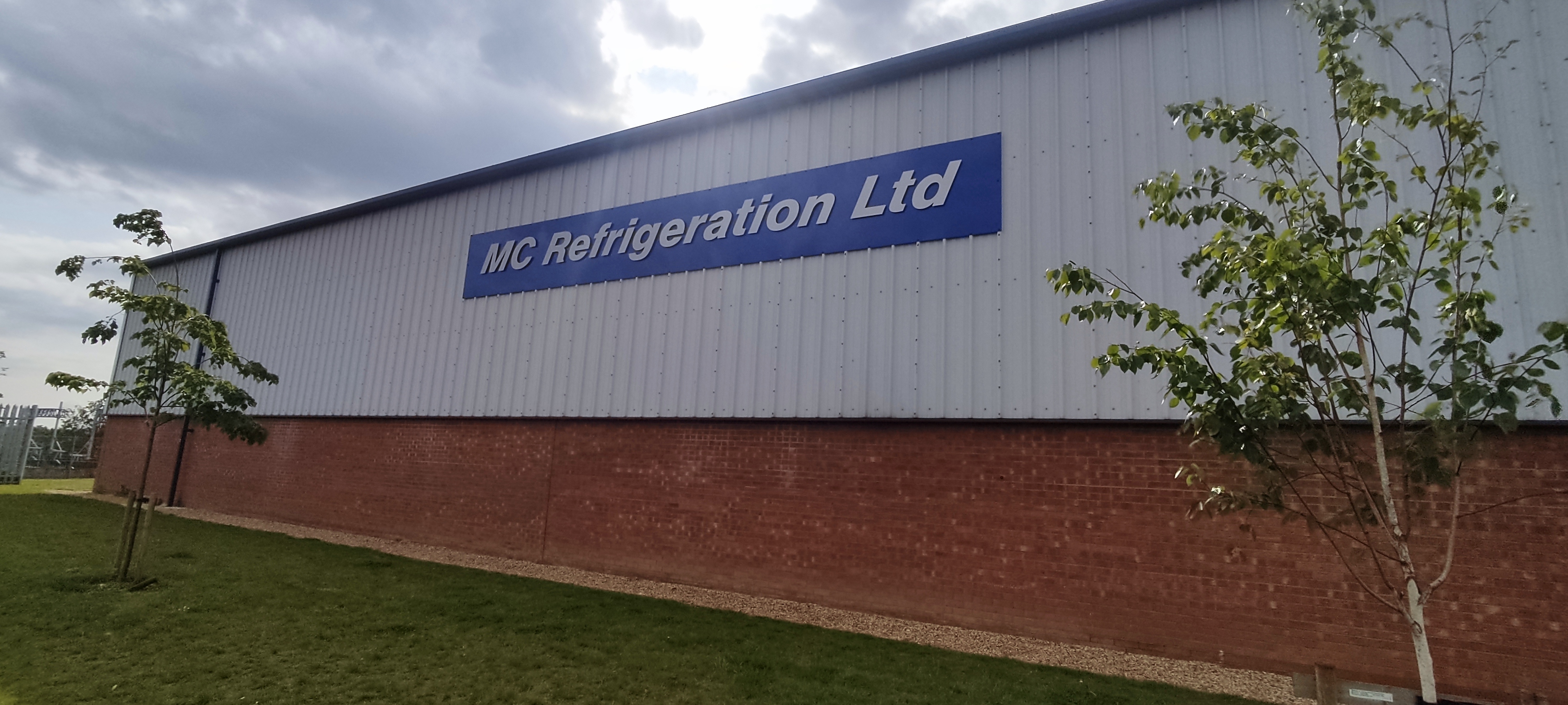

There is some great advice / knowledge in this post regarding sheet materials. We refer to this issue when explaining different material types to our customers as "thermal movement", not sure the term is correct but it certainly gets the message across.
A number of years ago, we would regularly use foam pvc for external signs but usually only installed within a frame to allow it to expand and contract without any issues.
As the prices in ACM fell it became a more cost effective solution to use this without a frame & has been pretty much standard practice since.
For flat cut letters we would always recommend acrylic, especially for external signage although ACM can work well too, especially if the job requires a specific colour / finish.
Attached is one we completed earlier this year in ACM, & we always use Penloc adhesive for the locators as this as seems to provide an excellent bond regardless of the substrate.
