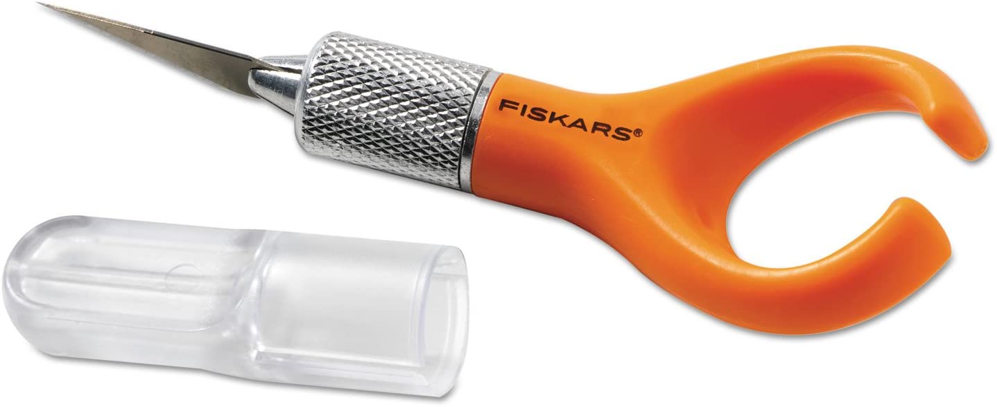

I like to use a finger knife because it eliminates much of the pressure of having to grip a tool. I turn the blade backward so it doesn't cut when I weed. Works amazingly well.

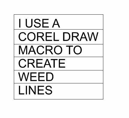

create weed lines

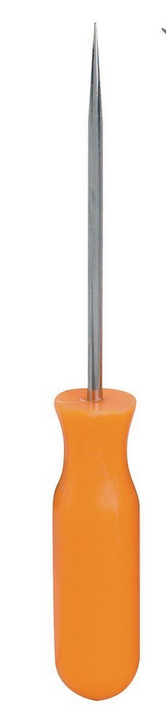

I like to use a straight shaft for picking

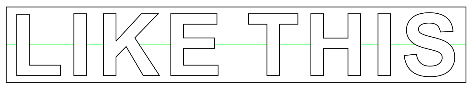

If the text is small and lifting off the backer you can add split lines to each line of text so that you weed only one half at a time. It allows you to hold down the letters to keep them in place.
Flexi will do it for you in the plot menu. It is also pretty simple to set up in Corel or Illustrator if you don't use Flexi.

What plotter and software are you using to cut with? Graphtec has a setting to not cut intersecting lines. So in theory you could just draw lines through your text and the plotter will only cut the segments in between.
I tried this a few times and it was inconsistent but it might have been something I was doing. Not sure how I would do it in AI. Seems like weld or trim should be able to subtract the intersecting lines but it does not look like it works with a single open path. Also shape builder would be an option but it just locked up AI twice
