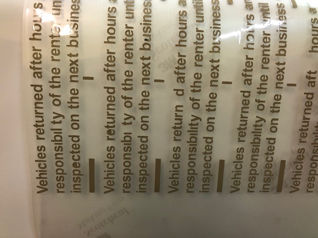

gabagoo
This pic I am posting is 3M 7725. I have cut literally thousands of these over the last 8 years or so. They are for a Key drop box for a major car rental company. The upper case are just under 3/8" and the lower case is 1/4". I originally used Gerber 220 Sandstone with a paper back and the weeding was horrible with many letters missing and repair work taking hours and hours. I then found out about the 3M 7725. This vinyl was amazing and you could weed all 3 lines plus cheats in one fast pull with only the odd letter missing ( old Graphtec plotter). I was looking at an Avery colour chart about a month or so ago and see that they offer a sandstone as well and decided to try using their 2ml version. I also bought a new plotter ( Summa S2 T series with the tangental blade). Incredible weeding and never any missed letters!!! I prefer the paper back as the 7725 although weeds great, is very difficult to get the cut graphics off the backing plastic, which was very frustrating for my client when they were decorating the key boxes. He is happy now and so am I as I have cut down my weeding time considerably.

I'd print on clear for something like that. You could give them all spares too for less than the cost of your time to weed that.
