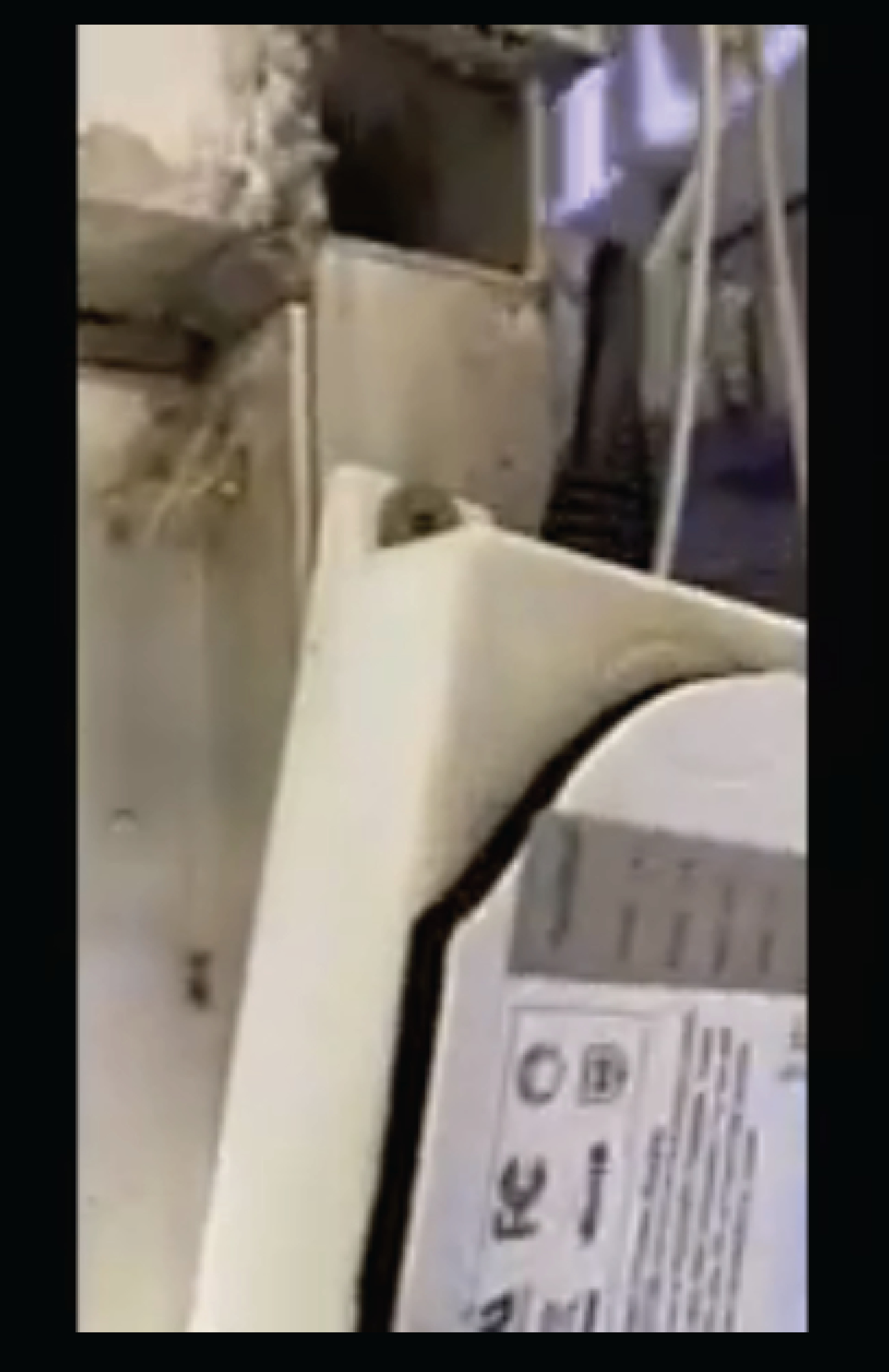

Well! I went back yesterday to swap the power supplies and see if one was faulty. I dont know how I missed this when I was there the other day BUT the one thats not lighting up was actually busted and a little brown discolorization at top of it. Ive got 120v coming into the sign and each power supply is running UNDER the specified load of modules it could handle. I called the supplier and they issued an RMA

the power suplly slit open and had burn coloring on top of it, im assuming this was defective
