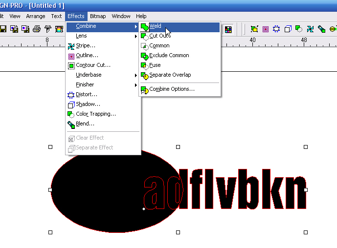

Highlight the objects you want welded and then click effects, combine, weld !

I know this doesn't make much sense but try changing the colors of both the Y & flame to say black (or any color, just make the change to both in same color). This happens to me sometimes... and changing the color works. Don't know why.. but it does...
In Flexi (and it's OEM versions) there is a parameter in the Preferences dialog box called Weld based on Color. If it's checked, only objects with the same fill color will weld. If it's unchecked, any color will weld.
bob
Check to see that they have exactly the same fill and stroke (if any) settings. You can only weld objects with identical fills.
Only if you have specified 'Weld Based on Color'.
If not, you can weld any object to any other object. The resultant composite will take on the fill and stroke of the topmost object. If that object is sporting an outline, not a stroke, then the resultant composite will take on the color and characteristics of the outline. In this case Flexi treats the outline as the topmost object.
