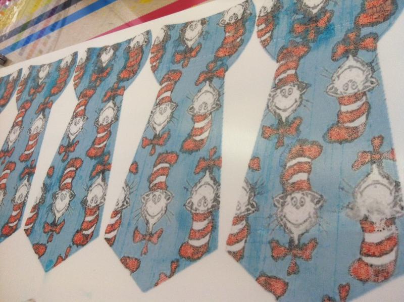

Ordered some rtape tattoo to do 100 shirts for my wife's school. They are doing a seussical jr event at their school. Made a bunch of dr seuss themed ties for the shorts
Got the roll from fellers this morning, put it and did a row to make sure they were good.
Looked at them after they printed and almost crapped myself.
Ends up the vinyl is on the roll backwords or upside down.
never had this happen in 10+ years of sign making

And yes a lot of heat transfer stuff seems to be rolled backwards.
Aka reverse wound.

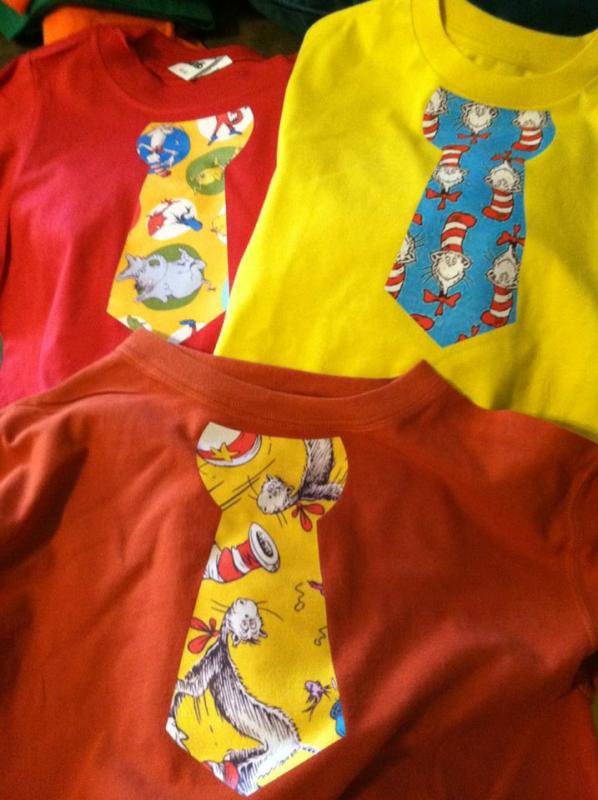

It's a new brand of heat transfor that fellers sells. Thought I would give it a try and i love it!
Here is some stuff I have done. Stuff works great. We use our SP300V to print it.

It is just "Reverse Wound", most catalogs/suppliers will tell you that when ordering. I've never had a problem with which way a roll was wound, have had standard vinyl that way & a lot of the time banner material is reverse wound to protect the print surface.

Always check the wind direction, surprised you've never seen this in 10 years. We order it one way or the other depending on the machine in question.
