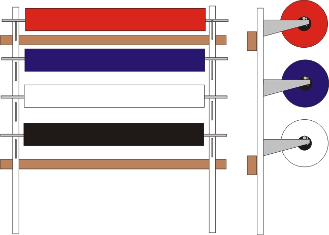

We used 2x4s attached horizontally to the studs of the walls. Then we attached shelving arms vertically to those 2x4s and put shellving arms to hold Conduit piping or some other bar of such to hold our rolls then we put bolts screwed into the ends of the shelving arms to keep the bars from rolling off. refer to diagram.

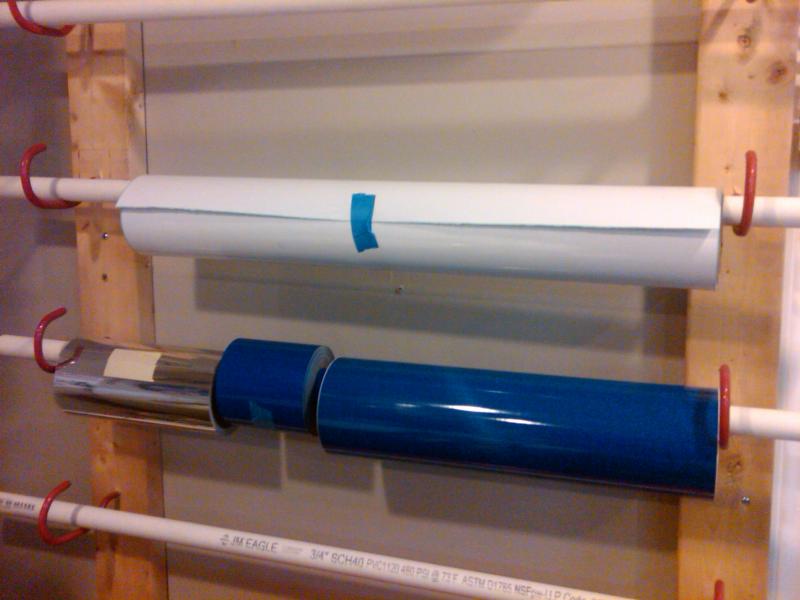

I have to admit I was inspired by GG's beautiful rack, unfortunately it take more than just a few pictures of a nice rack to inspire me to work real hard at it so I made my own easier way to do it. I never have customers come in here so I really don't care about the way it looks as long as it's functional. A few 2x4's and a bunch of bicycle hooks I picked up on ebay for $1 a pair and some pvc pipe. Works for me...:clapping:

Hey that doesn't look too shabby mate!
Can I ask - do you think it's heavy duty enough to hold a roll of 60" vinyl of 50metres? I'm also on my way to putting one of these things up in my shop.
I would use a nice thick pvc pipe for it but I would trust it. The 2x4's are screwed into the studs in the wall so they aren't going anywhere.

the design wasn't mine, i was inspired by jiarby's rack, just made some of my own modifications and had to have silver rods...
cuz girls racks are suppose to be prettier than boys.
if you have access to a CNC, jiarby posted his template... certainly much faster than my way.
yours to do the trick just fine bayshore!

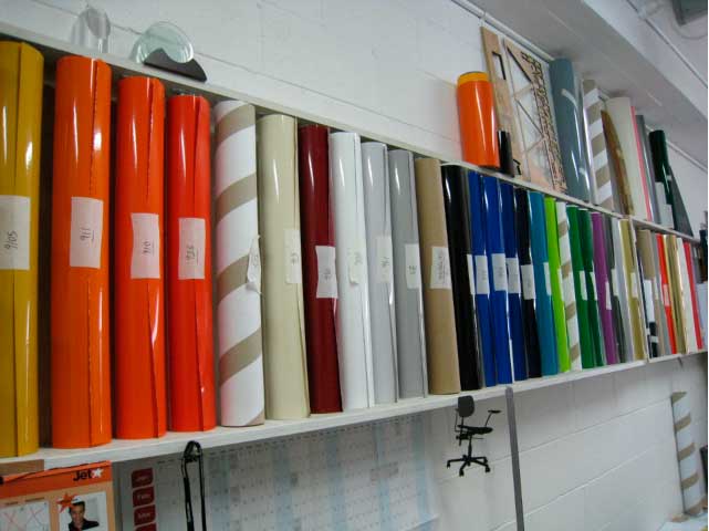

for coloured vinyl - we don't use much, so they're never that heavy - the most i keep is around 10m, and it seems to work fine for that.
this is mine, it runs along 2/3 of the wall and can hold around 50 or so rolls. has served me well for the last few years.

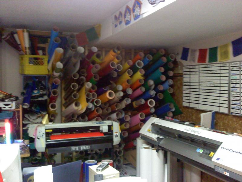

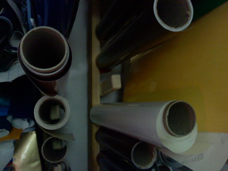

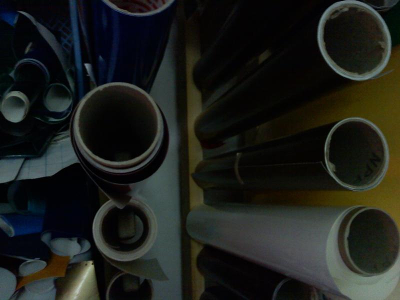

Mine is less look good and more space minded. My rack is not nearly as nice as GG's, but it holds more up.

cool to see how everyone uses their space. i like how tidy the rolls look lined up against your wall Custom Grafx.
holy smokes CentralSigns, that's a lot of vinyl!
i'm tempted to comment on "holds up more" but i think i'll leave that alone.
