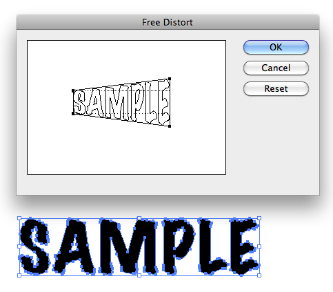

One of my beefs with Illustrator is the very small preview for the "free distort" function. It has been the same for several versions and the trial of cs5 I used did not fix it, so I may have to wait for cs6. The preview of this filter is so small that you cannot fine tune it in any way
I have others, and will add them in later posts

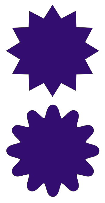

Wish list for Illustrator....
Corel has the ability to convert points on a polygon and then each point on that polygon mirrors what you do to those points
On the attached sample, in Corel you can create this multipointed star, convert JUST 2 points into a curve and then adjust the control points. When you do this, ALL the points on the polygon follow suit. In Illustrator, when you adjust one point, only the one point of the polygon changes. There is no easy way to make the bottom shape in Illustrator look like what I have attached. In corel it is a couple of easy steps
