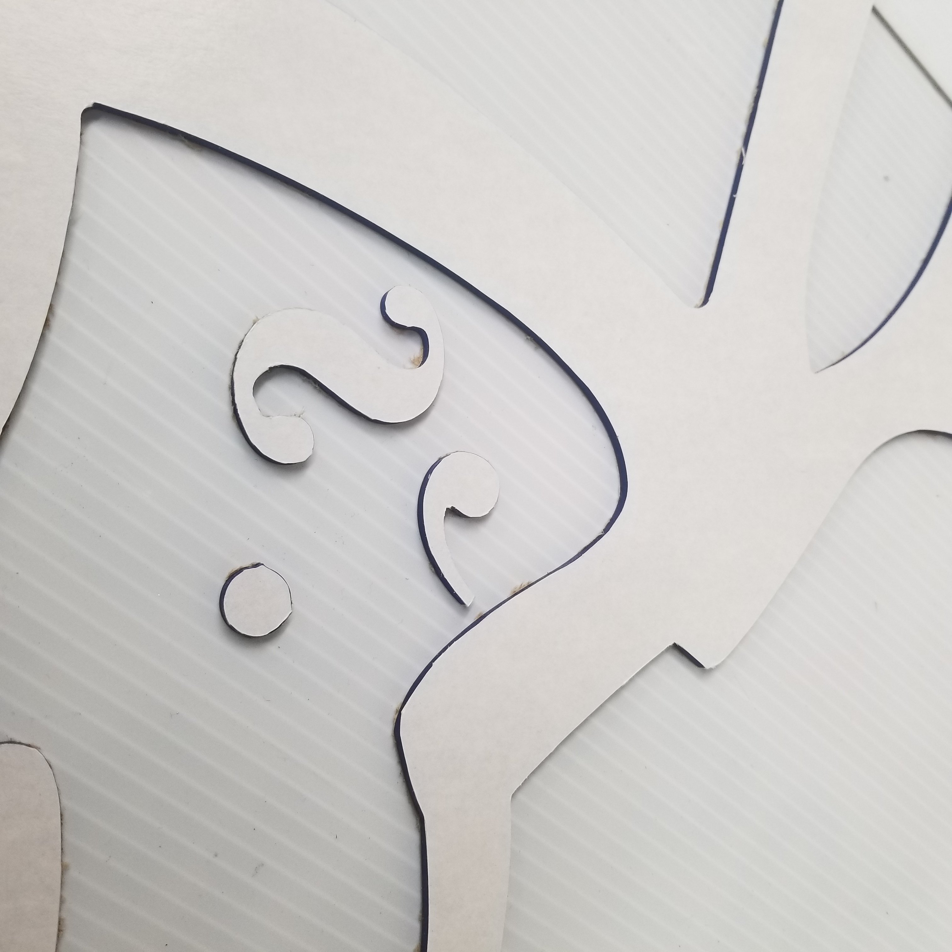

We are doing a lot of work that includes mouthing large and small letters to Gatorfoam, different kinds of plastics, and regular foam.
We use General Formulations Clear Mouting film to do it and it is so extremely time-consuming.
The film is ridiculously sticky and nothing can stick out of the letters.
We were thinking of using some kind of runny glue but one of our employees says that it will not go well with the foam.
Do you do this in another way and in that case how do you do it?

Still,considering the picture you posted, my best guess your easiest solution is to get one of those adhesive-dot dispensers from an office supply store and just place those little ~1/8" adhesive dots as you see fit while bonding pieces. no backer peeling or cutting through the adhesive required.
