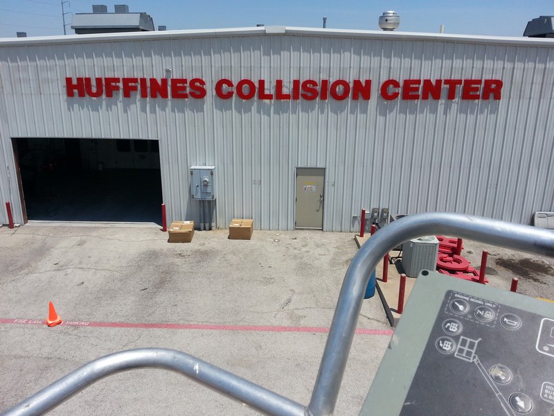

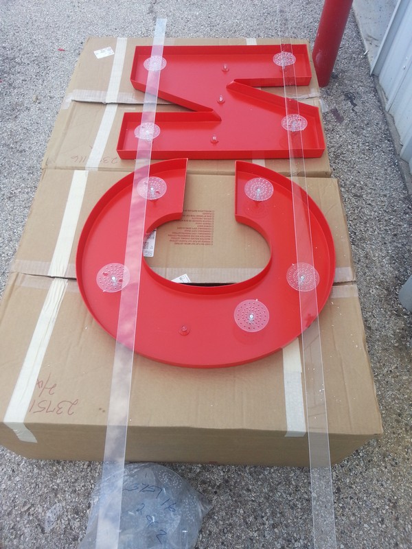

For flat-on-flat, Weld-On 3. You can simply lay the hanger bar on the face and using an applicator, the Weld-On 3 will flow between the two pieces nicely ("capillary"). It's nice stuff and extremely strong.
For uneven surfaces, the Weld-On 16 works really well. The attached photos show an install I did recently using pad-mounted letters on acrylic strips. The pads weren't perfectly flat and the acrylic strips would flex when installing. The 16 is really thick and fills gaps really well.
