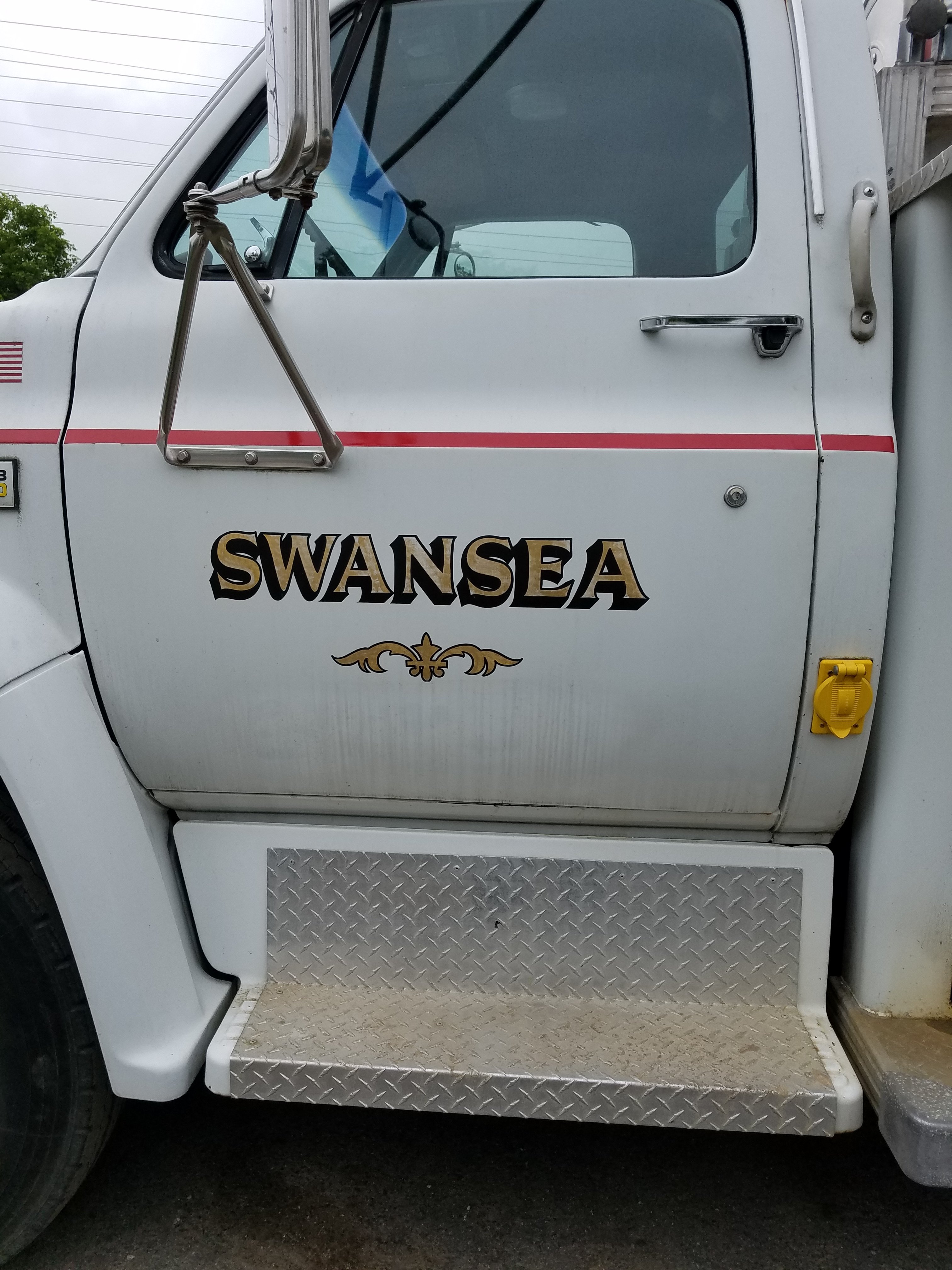

here is the truck.
Is that gilded, then hand-painted shadow and outlined, like in the olden days ??
Yeah, if ya wanna do it, I'd buff it out and then polish, but I'd prefer sending it to a paint shop. Take about 20 minutes a door. Gold will make it take longer.
Sheesh, even that little thing underneath is hand-outlined ??​

Yep, what Gino said. Back when I would use the easy off method and never liked the results. Seems like people were more willing to compromise back then.
I often ended up designing something that would hide the old lettering like adding a panel background
Just had something similar come through, we took the trailer to the body shop, to get removal done properly, customer was happy to pay the body shop for the removal.

Send it to a paintshop, you rub through any clearcoat or top coat and you will be up for a repaint at your cost..

That paint looks pretty faded.... Like the others say, take it to the shop..... 40 years ago, it would have been acceptable with a "it's the best we can do".... now... no telling what someone will say or do.
