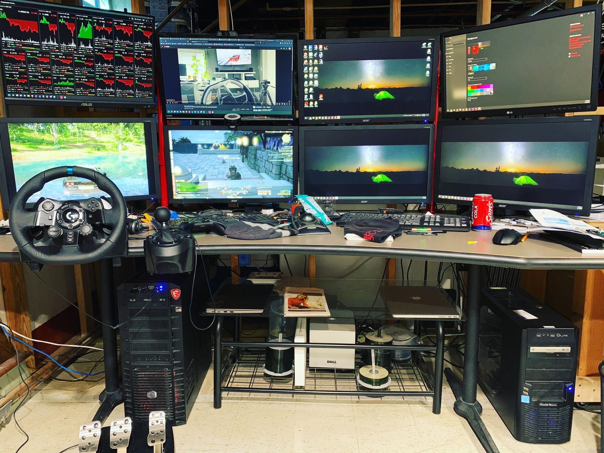

I have the all in one setup, and I know my setup is way over the top, but AMD Ryzen 9 3950X 16 core, 128GB of Memory and GTX1060 6GB running 4 monitors. (left), the system on right with the other 4 monitors is my other job. I live in my basement lol.
edit: i originally built the system myself in 2012 and have I upgraded internal components over time.
