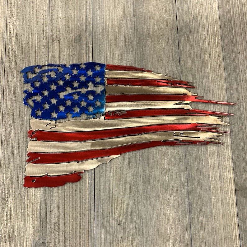

Have a client interested in some custom cut signs, but is looking for a shiny metallic / foil sign material (see photo attached). What kind of material is this? Who can supply this? (doesn't have to be layered, can be a flat sign). Thanks in advance!

material-wise, it looks like .040" metal laminate in various colors&styles.
we've got a sheet here that has that same blue & grinder-style swirls but I cannot for the life of me remember where it came from.
however, if you can get away with a flat "replica" then i would just look for a metalized film like a chrome or ultraleaf, and then just print the colors on top and the vertical swirls in a light greytone and apply to whatever substrate you like.

It looks more like steel, plasma cut, with whatever stain/coating that got popular a few years ago. Stuff sounds like what mikepro describes. Big question, is it magnetic?
bowtievega
The silver layer looks like it has straight brushing on it, probably .040" brushed aluminum. The red and blue parts are random hand ground finish with tinted clearcoat for the colors.
