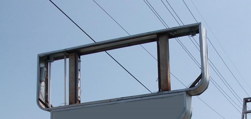

A customer of mine wants to paint there sign box another color. It currently is white and he wants it to match his company colors. Can anyone recommend what kind of paint i can use. Of course, looking for a very durable paint that we will not have to worry about. Thank You

Ronan's Speednamel is pretty nice stuff.
Love....Jill
PS I'd clean that first and lightly scuff with a Scotchbrite pad.
visual800
I would go with concept dc if you really want a high cost recoate if you dont I would scuff that thing up and spray with gloss PPG permorance latex or coronado Rust Skat, latex is not what it used to be. We use a lot of it and it will look great on this can and last
