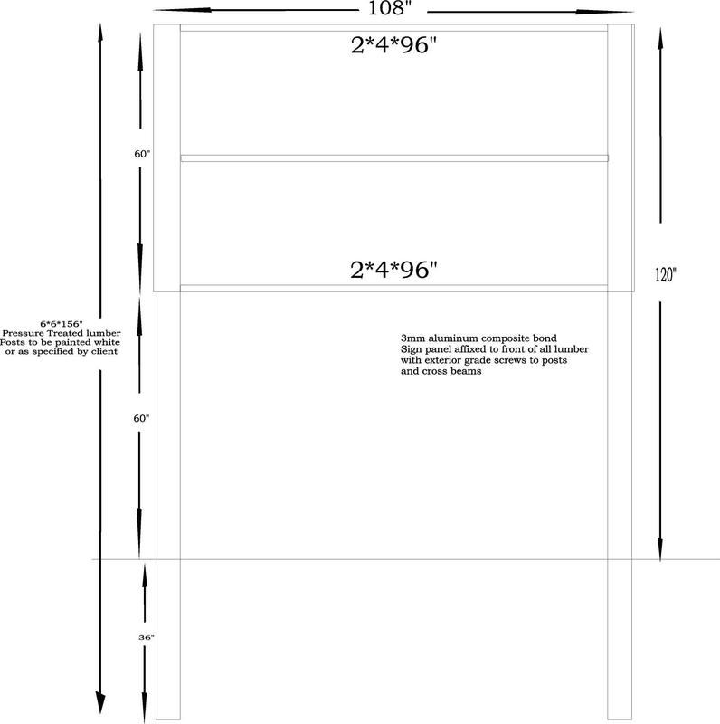

How does this look?
ChaseO
In my opinion, you need to bring your posts inside of the 108" Make the post around 7' apart or so and run your 2x4s vertical instead of the horizontal you have shown.
I mean flat against the posts instead of turned sideways in between em.
