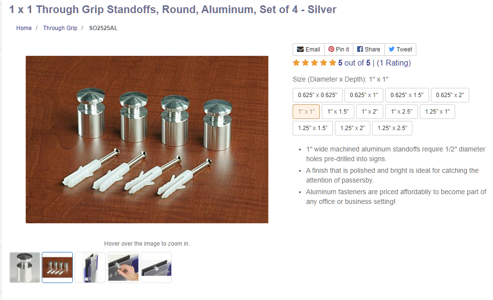

Hmmm...maybe I better ask which spacers to get. It's drywall. Is this correct? - Gino, I like the idea of the non-glare
Yeah, we never use the ones provided when buying those things. I guess they're Okay, but I like heavier ones for better sleep at night.

Why is that just about every piece of hardware you buy, even supposedly professional grade, comes with crap fasteners
