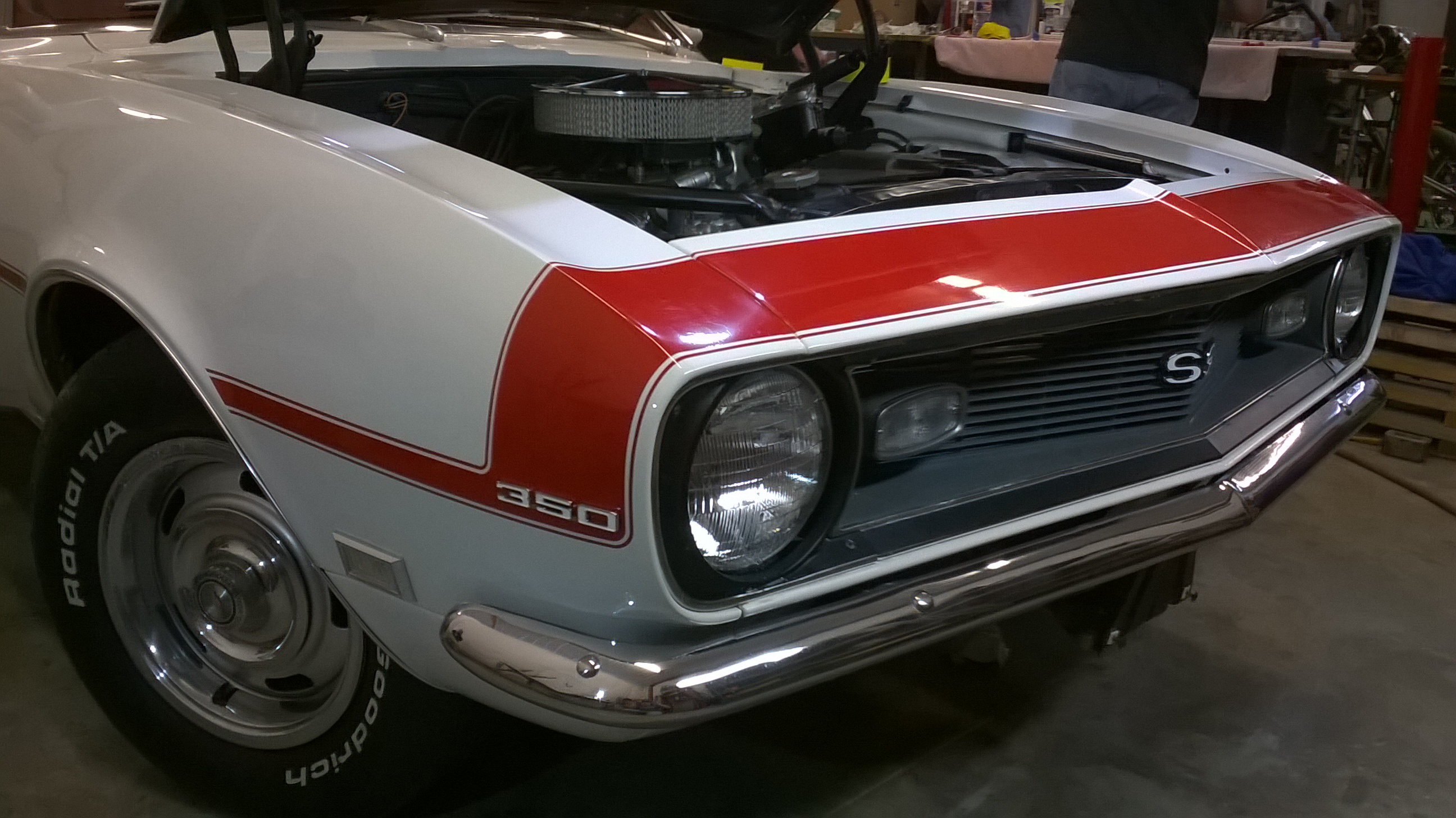

Gino, don't assume that just because it is offered for sale online that it is going to work and if it doesn't that it's the installer's fault. The most recent job that we did which involved ebay car graphics was on a 1968 Camaro. It belonged to a guy whose offshore race boats we had done for a decade and we'd also done signs and graphics for his marine businesses. He buys and flips collectible cars on the side, and this Camaro was one of those. He had taken it to a local body/restoration shop to get it spiffed up for flipping, and they had ordered the nose graphics for it online from an outfit that claims to be selling factory reproduction graphics for old cars. They have vinyl installers at the body shop, and they went through two sets of these decals before giving up. Then they hired one of our competitors to install the decals, and went through two more sets. Finally, they called the owner and said they were giving up. They still had one side of one set of the decals on hand. So the owner called me and asked if I could rescue him and get it done because the car had to leave in a few days for the Barrett Jackson auction. I took one look at the vinyl and said I wouldn't do it using the kits they were ordering because it was intermediate vinyl. So I used the piece he had to scan and create my own. Did it in cast vinyl and went to try installing it. It didn't work--because the shape was all wrong. Nobody could ever get that decal onto the car, over the contours, without wrinkling and creasing it, and even then it wouldn't line up with the stripes on the sides it was supposed to. The angles were all wrong. So I worked from photos of what it was supposed to look like and drew my own pattern on the car, and cut them again. Then it worked. Still hard to install, but it worked. We got it done in time, too, even though the body shop and the other sign shop (which claims to be a wrap and vehicle graphics specialist) wasted over two weeks but I only had 3 days. I charged for all the time it took to design and install, with an extra 50% for the rush and putting aside other work. And the customer was happy with it, particularly compared to the bill he got from the body shop--they charged for all the time they spent and all the sets of graphics they wasted, and the other sign shop that failed also charged for their time.

I'm not assuming anything. That's almost what I did for the truck here a few weeks ago and it turned out great. I don't have any pictures, I forgot. The vinyl was supposed to be black, but it had quite a blue hue to it. Looked odd. I also tried fitting his decals to the truck itself and it was off a little bit, so I also altered the measurements to fit. It too, was not cast, but was some odd kind, but it was marked 3M on the backside. I used color change wrap.
