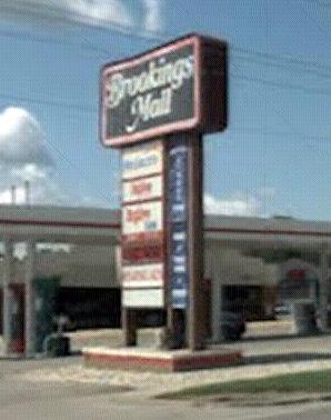

Sroufe7
Thank you for the replies. I honestly don't want to do the sign, but I don't really like telling people no that are good friends. But we'll see what happens.
I have attached a picture of the sign.
It would be the first white sign under the black main sign.
Right now, the business that has the top spot moved out of the mall and they removed the signs and flipped them around so you can't read there name.
I don't know the actual size of the signs. I figured if I was going to do it, I would measure what is there now and get some new pieces and put the lettering on them and install them at the same time as taking the old ones out.

Yea, that should be simple. Everything is already there, you just need to get an acrylic (or something of the like) substrate, and stick it in there with your translucent vinyl on it. The picture is extremely small, but it doesn't look like it is a molded formed face from what I can tell.

Okay, I take back a little of what I was saying earlier. This is much smaller than I expected. Looks like about a 3' x 8' or so.

Looks like that panel is no bigger than 3x6 and no more than 15' or so off the ground. Do what the others say as to the proper permit and insurance.
The problem comes in if you don't have access to a bucket truck or scaffolding. You will need to get up there to measure the faces. If you are replacing them you will need to slide them out a little to get a true measurement. Then you will need to fabricate the new faces, go back out and remove/replace the faces.
If you are reusing the existing plastic it can all be done in one day. In this case you should be able to rent a tow behind trailer lift if you have a truck with a receiver hitch. Do the job in one day and cash in.

The size of the panels are 96" x 38" x 3/16" and it's about 20' up.
