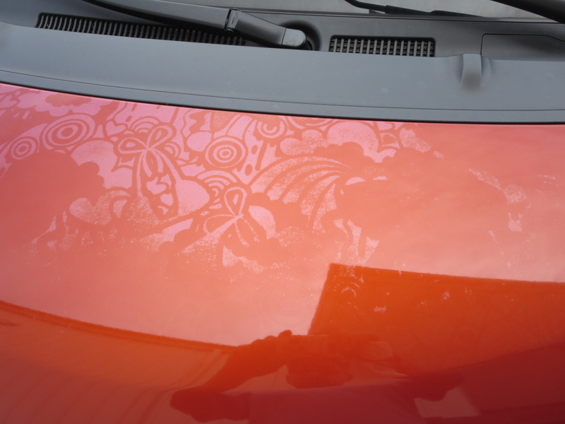

Had a car in the shop today to have a wrap done by another shop removed.
Cars a 2014 with less than 9k miles.
Wrap could not have been on more than a year and half, more likely less than a year.
The print vinyl had to be 180C - had the right color & waffle pattern in the glue.
Sides came off with zero issues and almost no glue.

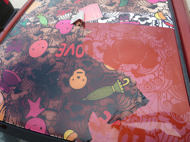

Hood & roof had turned black and spotty.
The material was a little brittle compared to the sides but it had not started crack and came off ok.

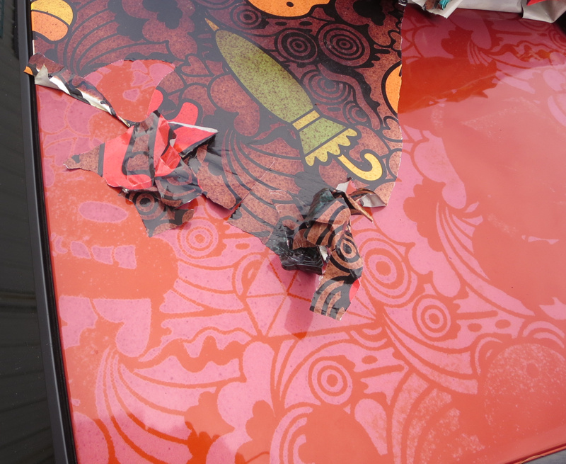

Problem is the ghost shadows on the roof and hood, they are now a permanent tattoo all the way down through the clear coat.
Our detail shop hit it with some compound and the buffer - just made them nice and shiny tattoos.......
It seems like the ink migrated right down into the paint (on the overlaps there was no shadowing).
The install was actually pretty good (with a few dodgy overlaps).
I have not seen 3M fail like this here before - at least not so early.

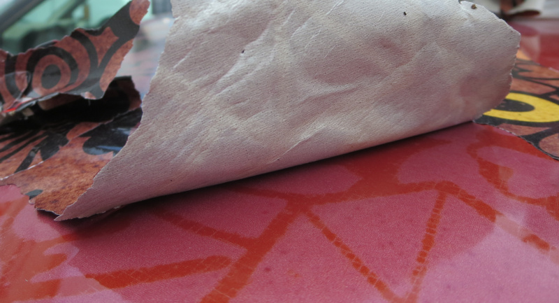

I took a pick to some of the material and was able to lift the lam off the 180 in pretty big sections - it felt like intermediate - too thick and stiff for 2mil cast. Almost like a floor lam.
I think the shop used a good print vinyl and a trash lam to maybe save on cost.
Anyone run into something like this or think it could be something else?
I have to show the customer the car tomorrow.
Maybe offer them a cover up wrap of the hood and trunk with some matte black or carbon fiber.
