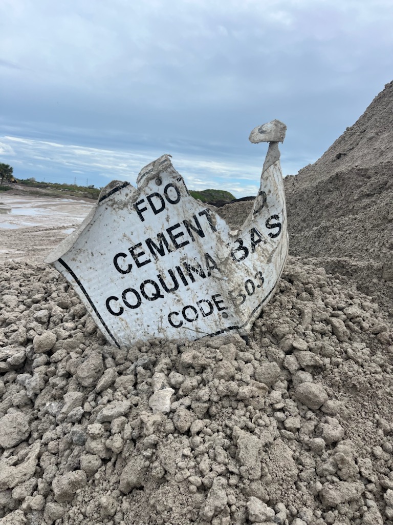

That's what they have now, it looks like the loch ness monster got ahold of it. Still attached to the posts though

That sign looks like it was in a hurricane and the sign stayed on the post so the issue isn't the aluminum.

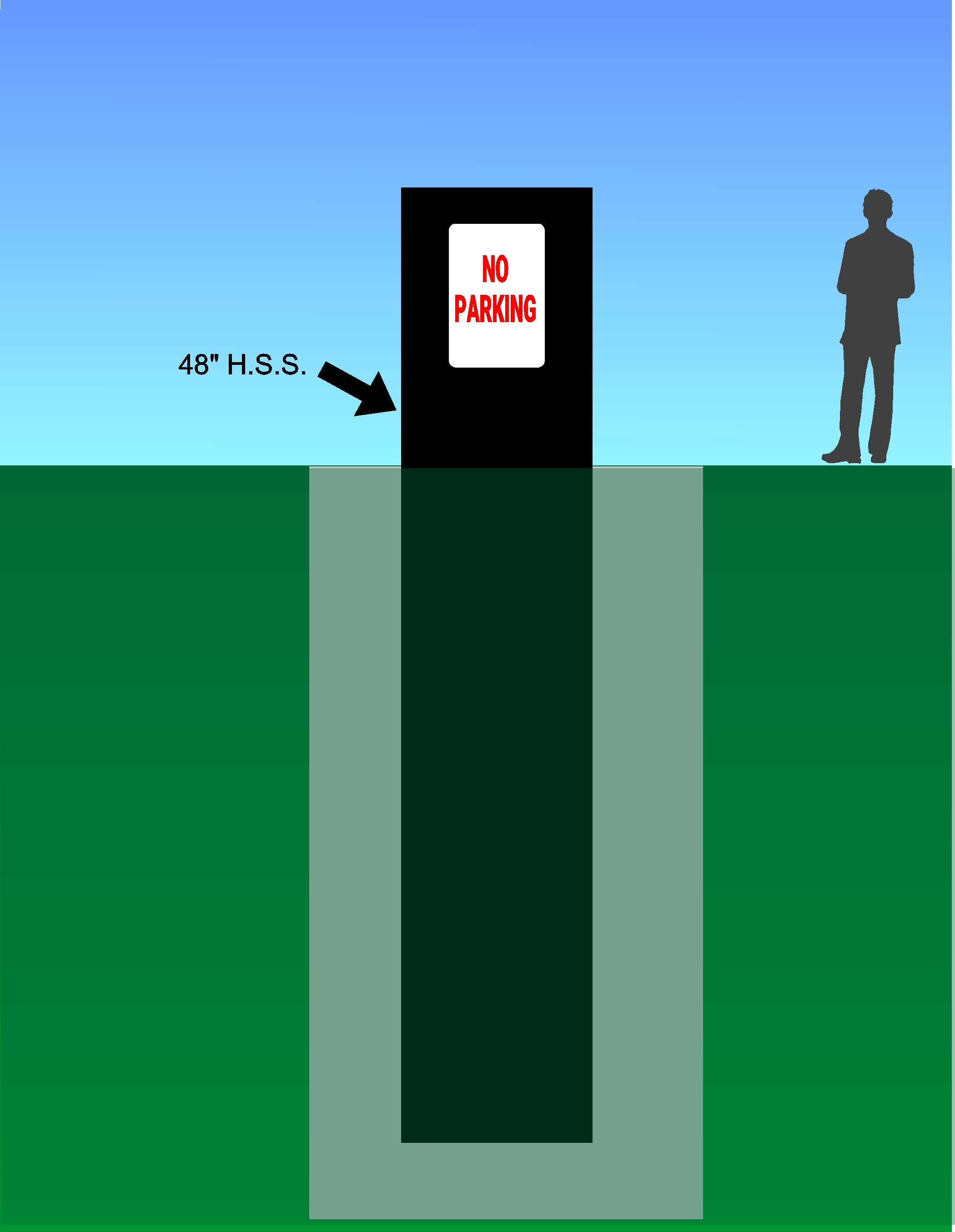

I would do something like the attached... anything less and it will just topple over... like Gino said. Do it right the first time. Might want to get your own engineering to verify.

Gotta get some rebar in there too, plus the crushed stone to hold the base off the dirt prior to pouring.
