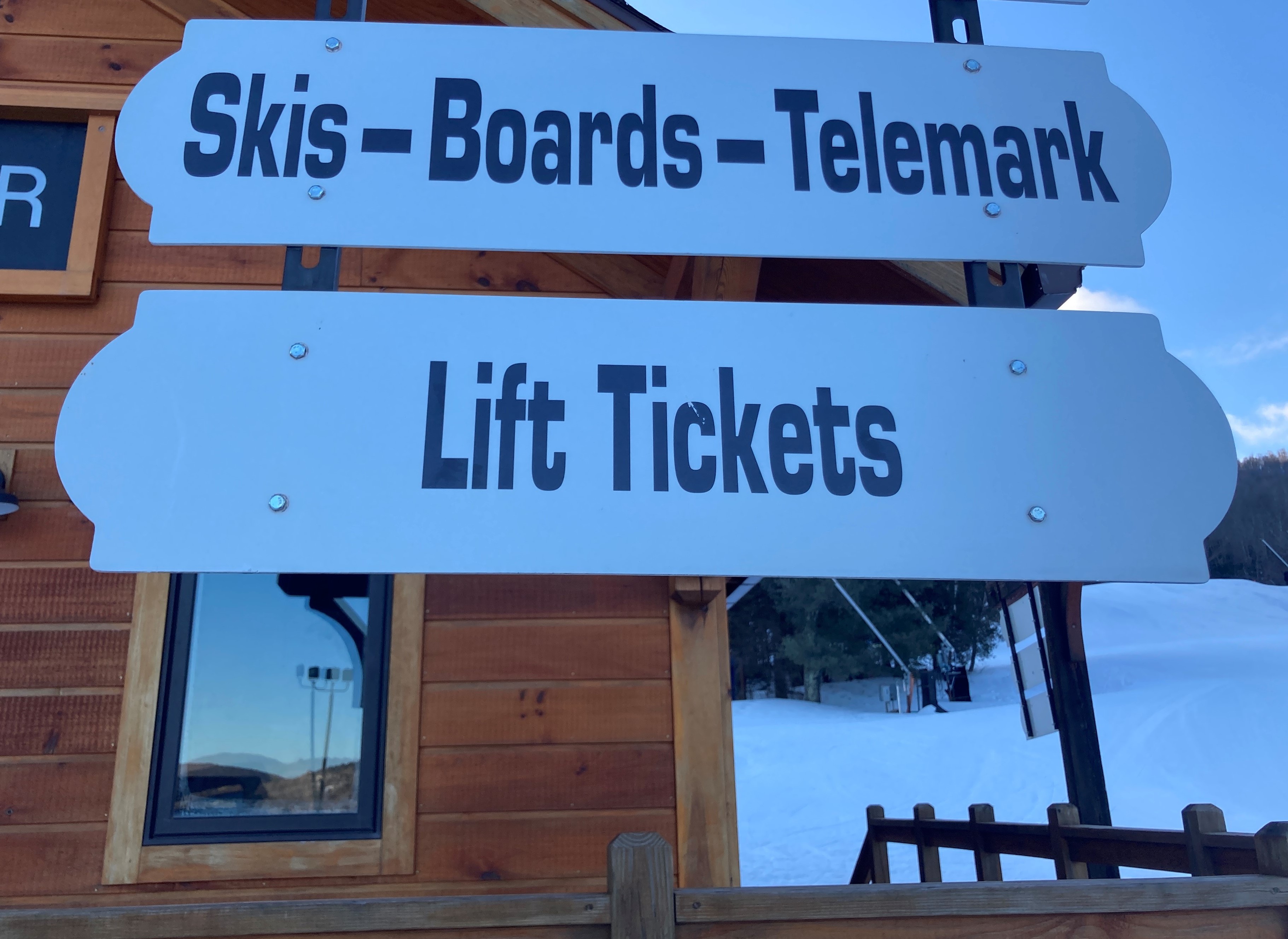

Does anybody know where I could purchase aluminum sign blanks shaped like the one in the photo? They are 36" long and 9"tall?

make an end template from plywood with a Jig saw, sand the edges smooth to the shape, and use a hand router with downcut pilot bit to cut the end shapes. . . very easy. . .

Check your local sign shops and see if anyone has a Cnc. This design is all over the web “ plaque outline” on shutterstock. Not sure what state your in but if your in Northern Ohio we can cut these, would only take a few minutes as long as digital file is setup.
It also depends on the thickness you need, not sure what we have instock for solid aluminum

Upload an Illustrator file at sendcutsend.com and they'll give you an instant quote based on the material you select.
