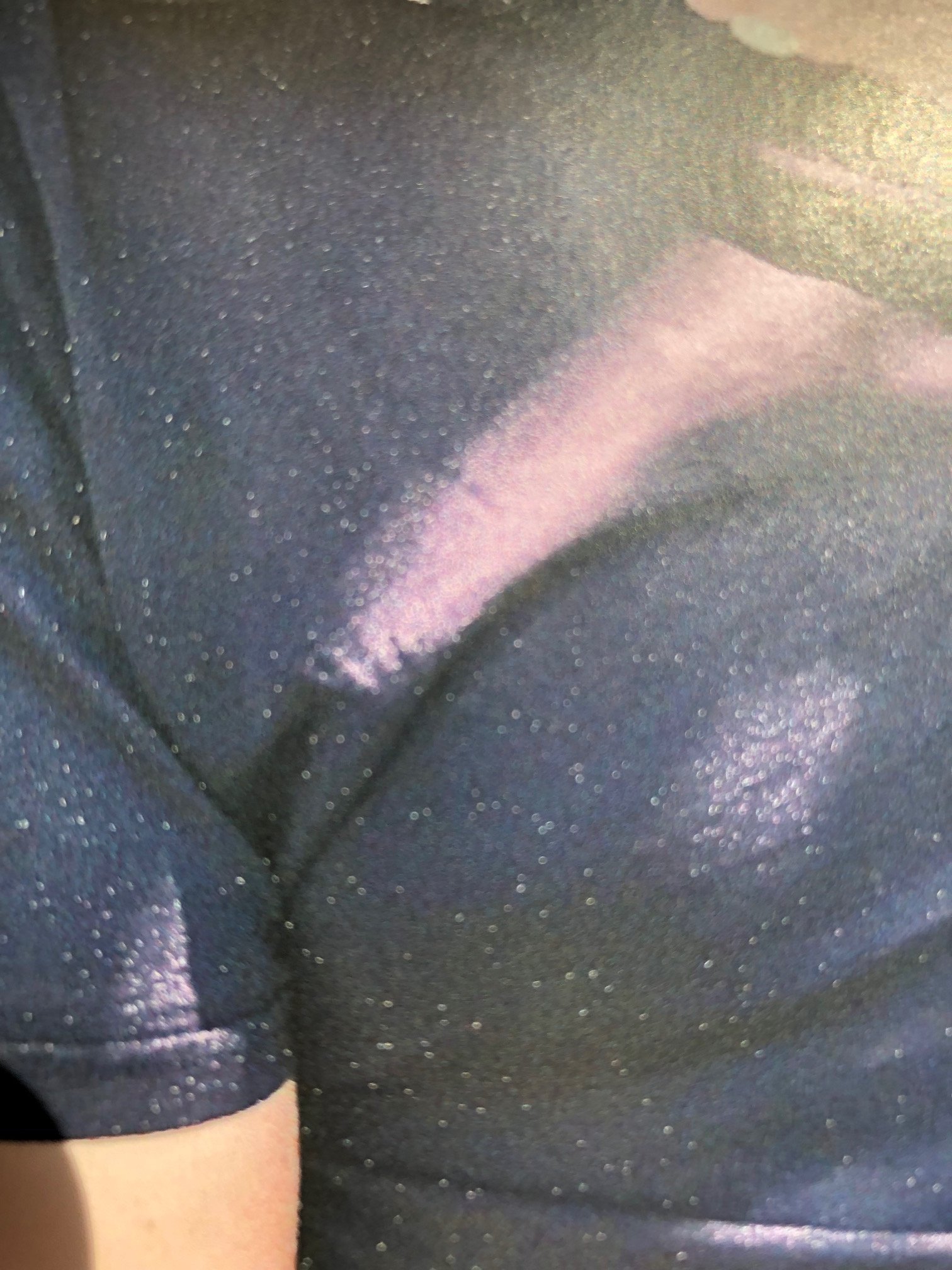

I posted this in HP forum, but kinda desperate for someone to answer. I am guessing this is a known problem with an easy fix? My HP latex 315 is printing white spots in my images. See pic. Any ideas or help as to why this is happening. I did just replace the optimizer cartdridge. The material I am printing on is 3M Ij35 matte. All my tests so far have spots in them or the ink is muddy looking.

It still looks like contaminated media. Did you try another media as suggested in the other thread?

Hello we were having the same issue with our hp 360 and IJ35C-20 media. We thought it was the media at first but then we thought it was something in our environment. After lots of tests and different media’s we came to the conclusion it was the media. We have had 2 bad rolls from 2 different suppliers at pretty much the same time but all is good now after we got some newer rolls

It was the media. You were right. Now I am getting greasy spots though. especially with dark colors. I increased the interpose delay and heat with fingers crossed.
