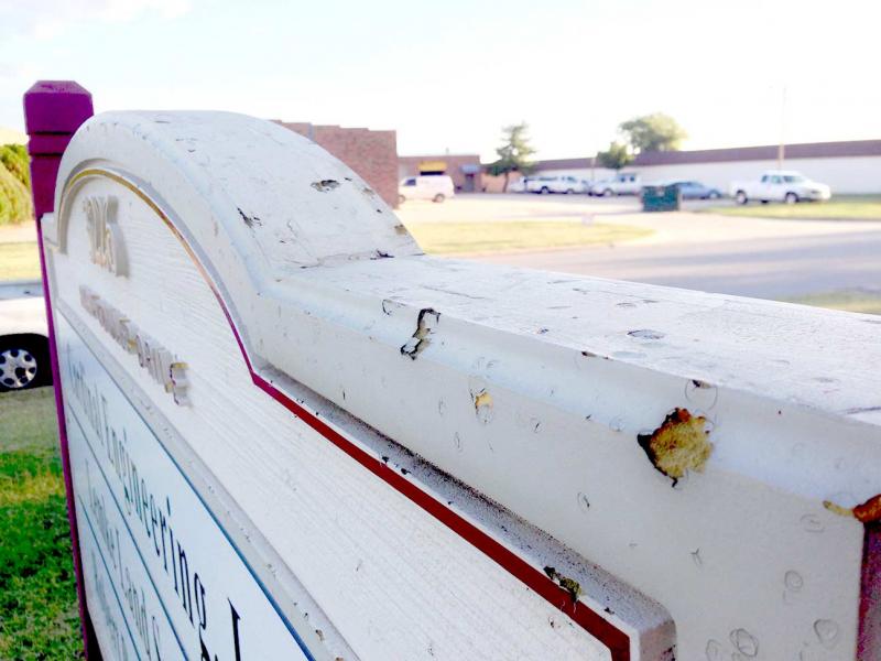

The move to this material comes about due to hail damaged using HDU. This year I've replaced four signs like the one's posted below

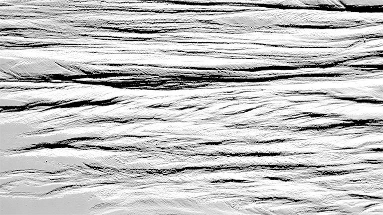

During a few spare moments I played around with a grind making wood grain. The photo is of a 12"X18" panel. It only took a minute or two to sculpt. It's an interesting technique to play with.

Most of the repairs we are doing now were sign not made by us. Can't tell what manufacturer but for all HDU doesn't survive exposure to UV as seen in the photo's

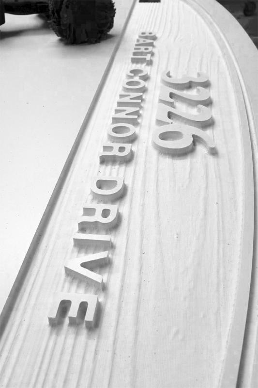

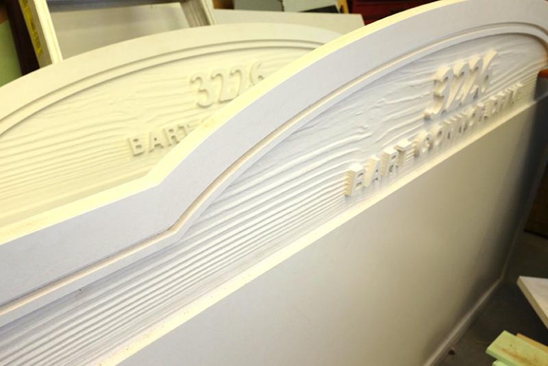

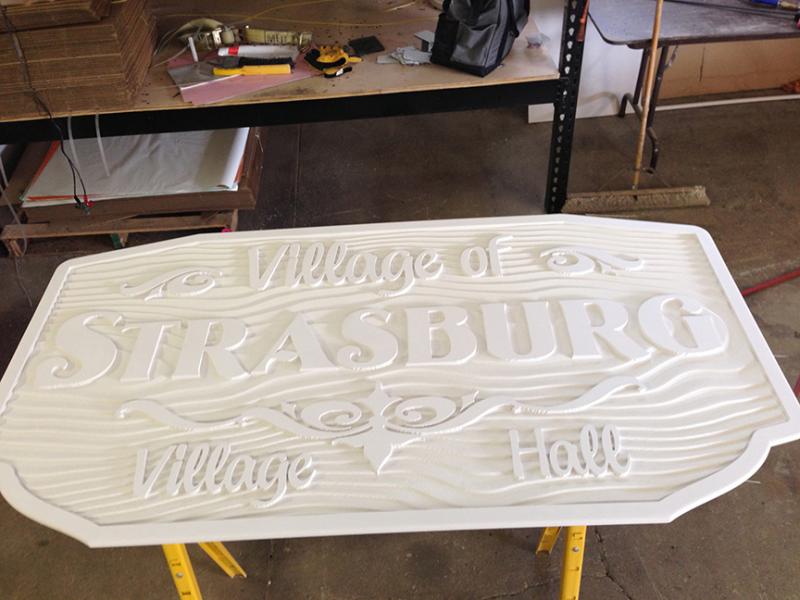

Could you tell me about the background on the Village Of Strasburg sign?
How it was created and routed?
Thanks
synergy_jim
Nice work!
Thanks

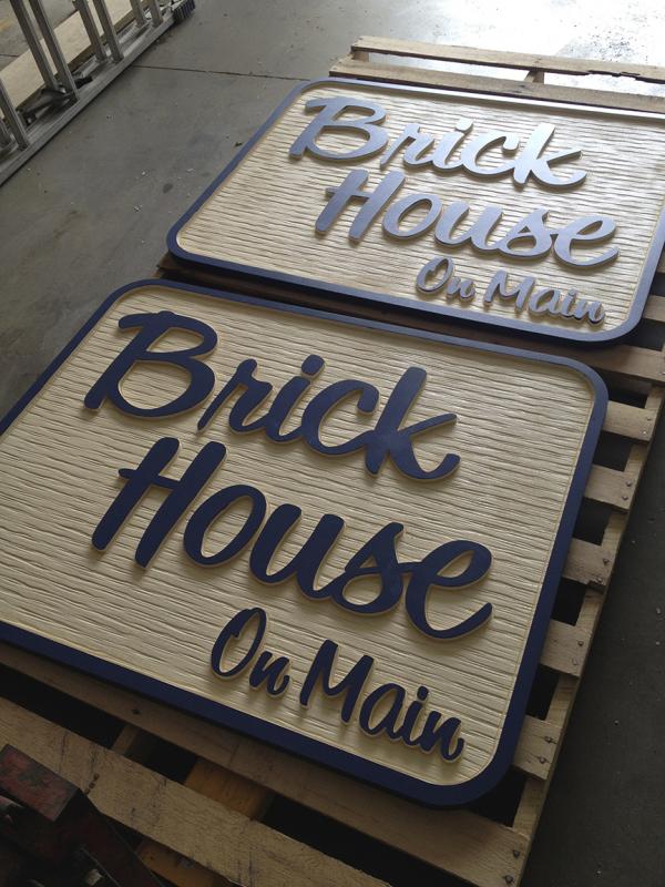

Woodgrain was created in photoshop and saved as a grayscale bitmap. It was then applied to the relief in Enroute using the bitmap function.
It was machined with 1/4" and 1/8" ball end mills.
