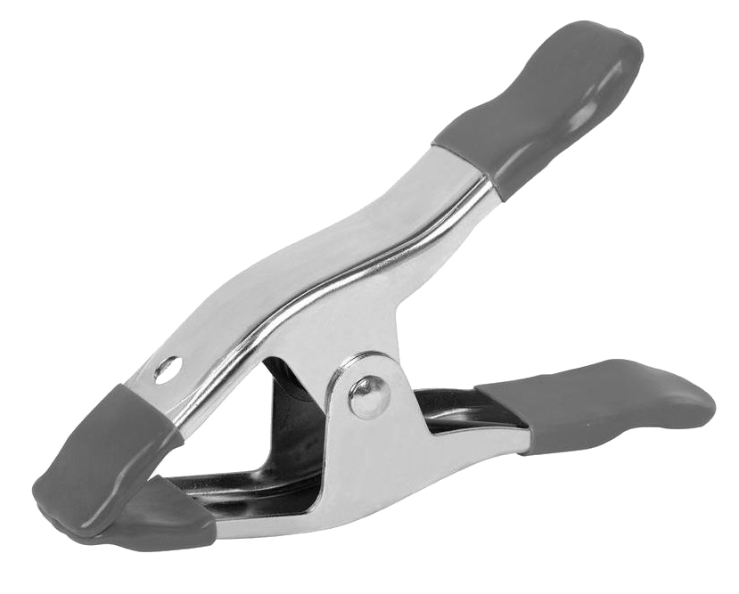

To help a customer out the other day, I delivered 40pcs 4' x 4' double-sided 6mm ACM boards. I didn't use any paper between them, as they were printed on the flatbed and well dried and cured. However, to prevent movement, we have these grip clips and we have 1", 2" & 4" capacities. So, I put 15 together very gently and gripped 2 corners. Made 3 piles in the truck and delivered perfectly fine signs with no scratches or sticking. Also had a ton of printed vinyl, which was rolled up in a 54" container. Nothing stuck together there, either.
These little guys really come in handy all over the shop for all kinds of things.
