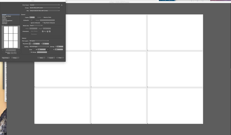

I know we have artboards now but, Illustrator has had the ability to do "multiple pages" since the early 90's.
Rick
Any version of illustrator can do this all the way back to V.88 or version 3... can't remember... but....
Sart a new page
Set your document to 51"w x 33"h (this will make 9 - 11" x 17" pages)
Hit CMD-P and you will be in your print dialog box.
Select your printer/page size - Under "GENERAL>MEDIA SIZE select 11" x 17"
Under "OPTIONS" select "TILE FULL PAGES"
Make sure your orientation is correct, you will see it in the window in your print dialog box...
hit "DONE"
Go to your tool bar and select the "PRINT TILING TOOL" on the lower left where the hand tool is and double click it...
Pages and print area will show up....
Rick
Now it's obvious artboards are better but this worked for us for years... this is what it looks like in CSS 2014...
